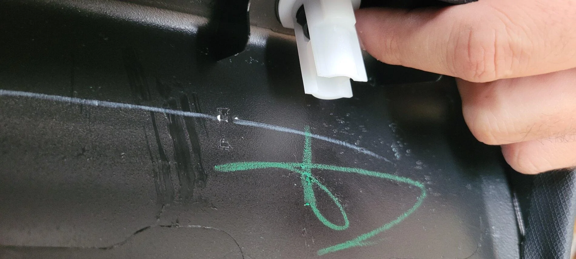

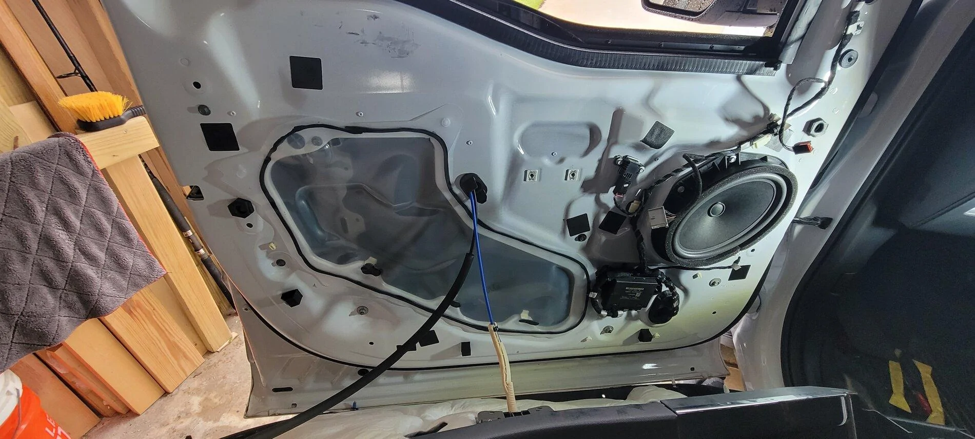

So like a handful of people here...I've had the driver-side door rattle (not the triangle cover by the mirror, already fixed that). But this rattle was coming from the door arm rest area.
I finally dove into it today and it could've been a couple things. Once the door panel was removed I noticed the plastic cover on the inside door panel wasn't completely seated, so I seated it back down (not sure if that was it, but at this point who knows). Then I noticed the door lock had significant play in it. So I shoved a folded shop towel behind it. Then tightened every screw on the door panel. One was extremely loose on the door handle mount. Took it for a test drive and no rattles. Hopefully it stays that way. ??. As I put more miles on it, I'll give an update.
