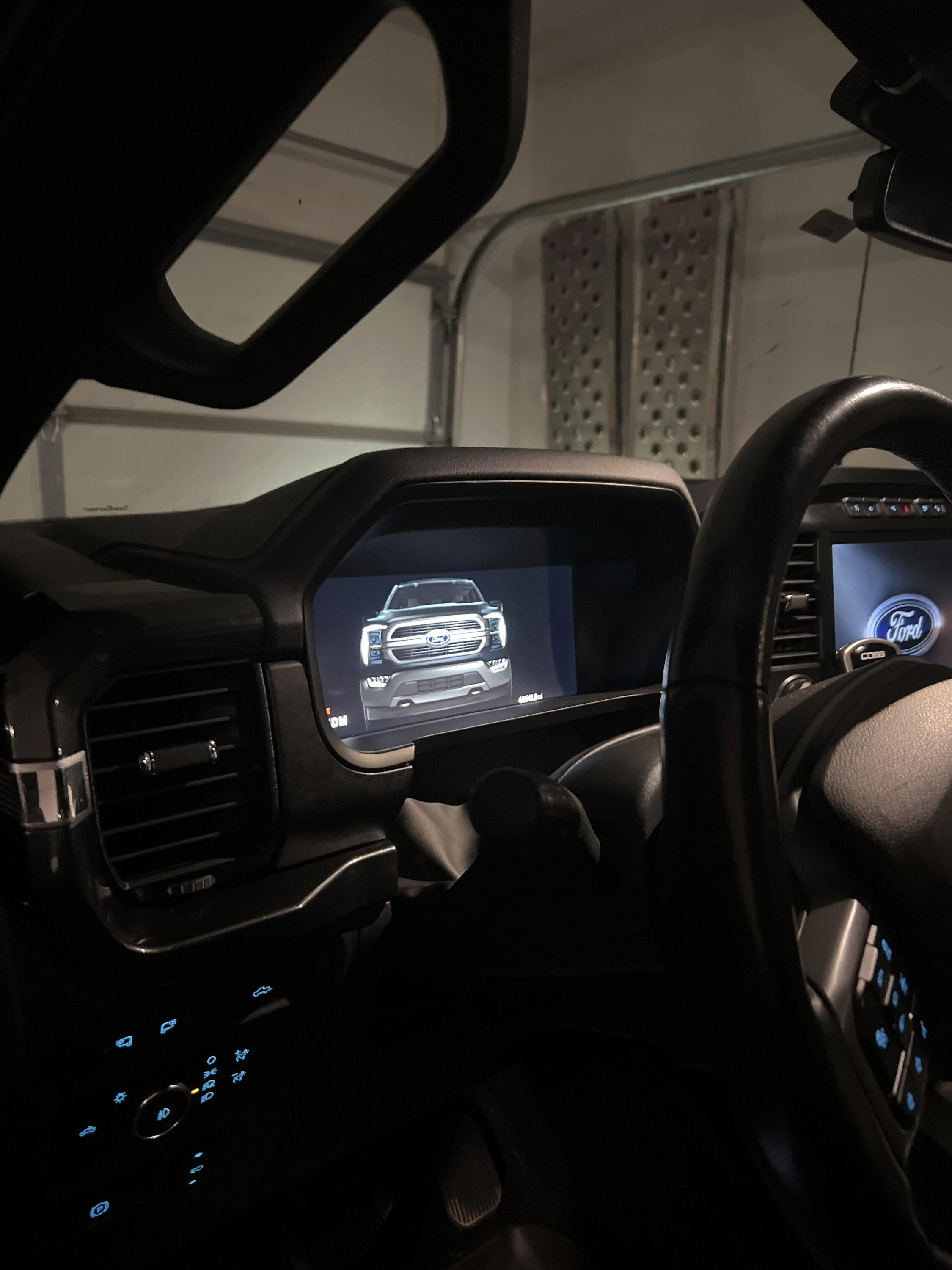

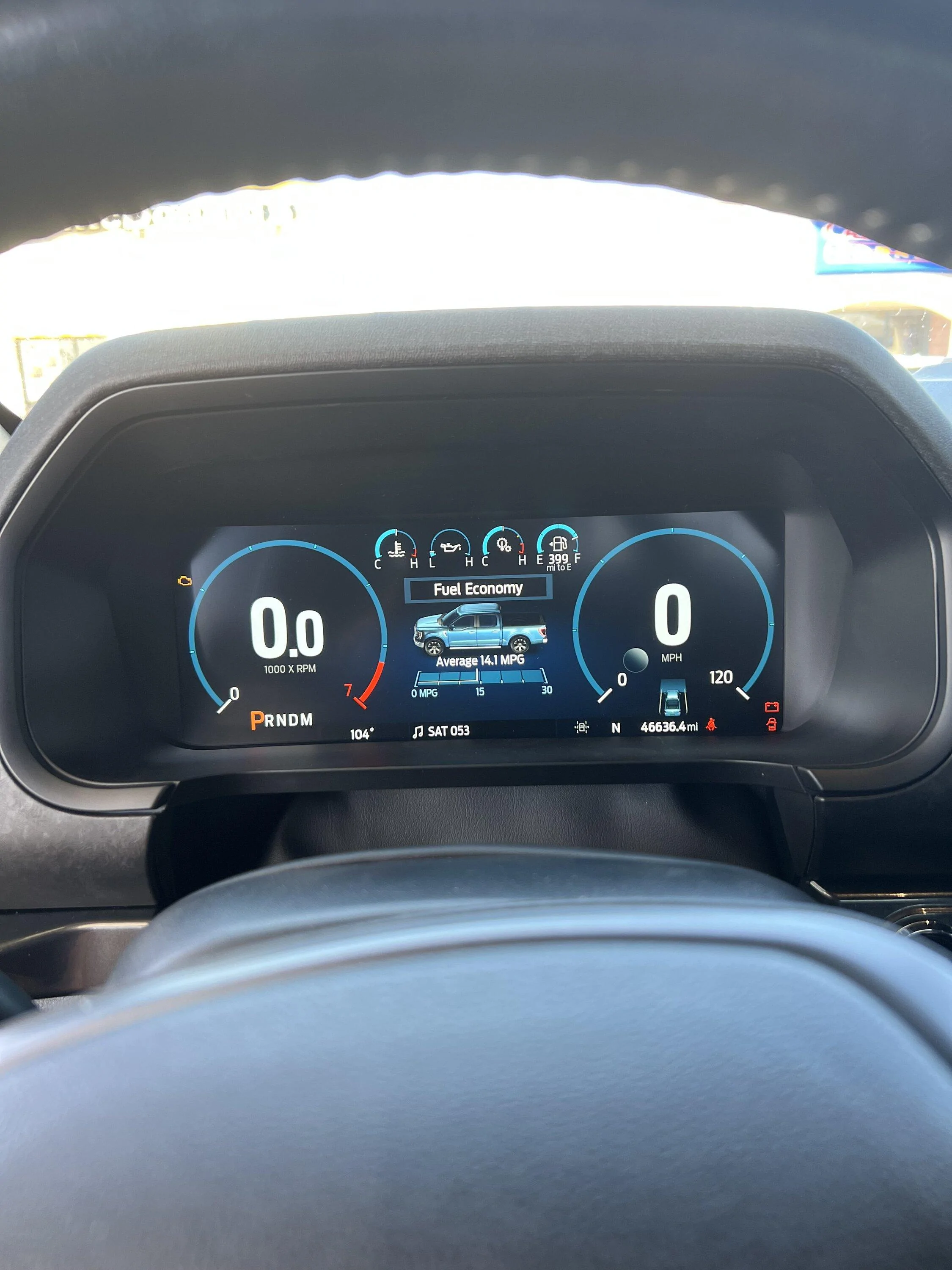

You can use cluster trim from a Tremor if you don’t like the chrome look
I purchase used “denim” dash pieces from eBay, as well as a used Tremor cluster trim, and got the cluster from Infotainment by itself pre-programmed
came out wicked nice, took me about 2-3 hours for full install, you have to take the entire dash apart and replace airbag into new passenger sidedash trim. It’s quite a lot of work but not terribly difficult if your patient and decent with tools.
