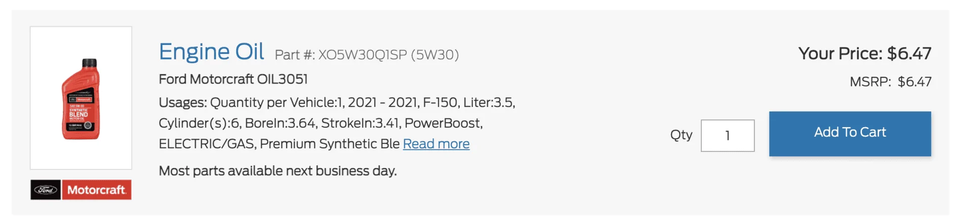

Given the way the PowerBoost uses oil during run-in, the main thing is to keep a bottle around and top up during the first 10,000 miles. The PowerBoost in my truck used about half the length of hi-lo crosshatched area of the dipstick in the first 5000 miles, but doesn't seem to have used any more, now at 8000+ miles. The usage meter says 40% oil life remaining. I'll swap it at the dealer at 10,000 miles and get everything else checked (e.g. battery connectors, undercarriage rust, transmission shifting.)
Ford F-150 10,000 mile oil changes, really? 1629310523602
https://parts.ford.com/shop/en/us/f...-oils/motorcraft-sae-5w-30-api-gf-5-8682937-1

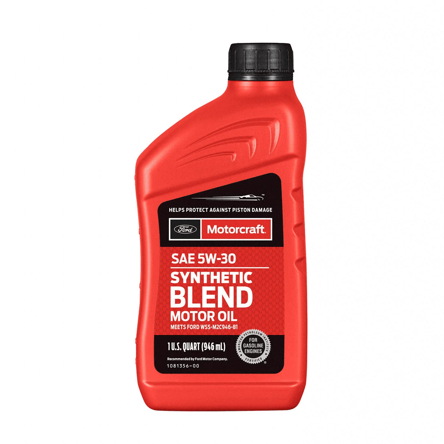

Ford F-150 10,000 mile oil changes, really? 1629310689959
Motorcraft® SAE 5W-30 Synthetic Blend Motor Oil(U.S.)
XO-5W30-Q1SP(U.S.) CXO-5W30-LSP6(Canada)
Specification: WSS-M2C961-A1
