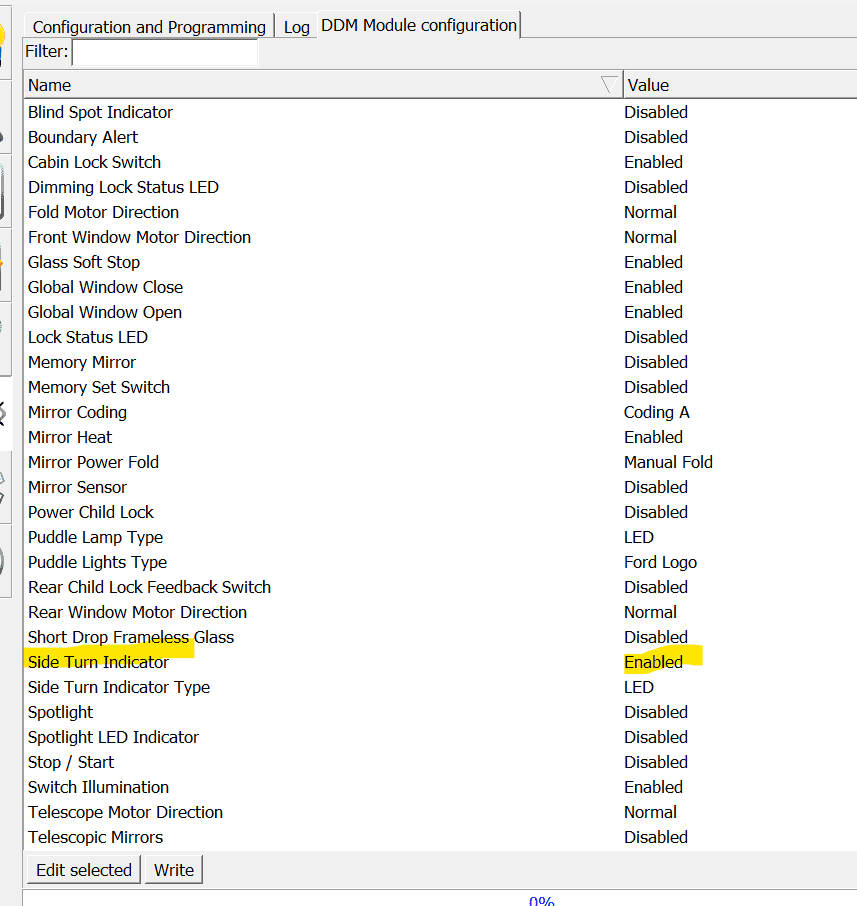

hmm made changes and signals are not working.
Yeah I tried it doing the simple way at first (using the section marked ‘as-built’ in the ForScan menu) and you actually have to change the physical code listed in that block by going to the section that doesn’t say ‘as-built’ next to it. So rather than enable/disable (like you have shown listed in the ‘as-built’ section) you’re changing a 1 or 0 in a line of code. Doesn’t matter what the rest of the code says, it all stays the same, you’ll just be changing a single digit

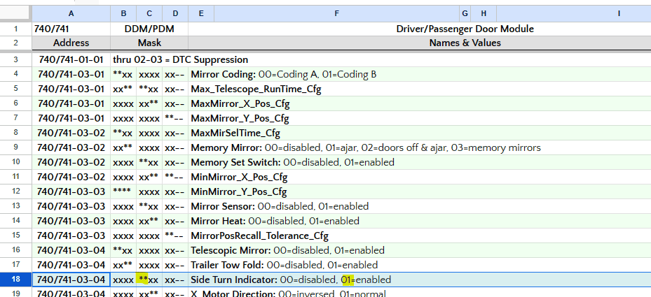

ok, I was wondering if that was what the issue was. I am presuming I edit the * in the code to a 01 to enable, correct?

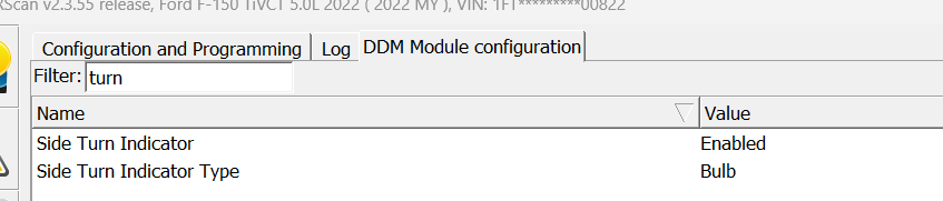

Try switching the type from LED to bulb for the turn and puddle lamp. I installed aftermarket lights and even though they were led, they wouldn't work if they were both set to led. Not sure how it affects the factory options, but might be worth a try.
still a no go.
Ford F-150 XL upgraded to Lariat side mirrors. How do you get puddle and turn signals to work? 1691499956972
Ford F-150 XL upgraded to Lariat side mirrors. How do you get puddle and turn signals to work? 1691499971124
I even did a hard module reset.
