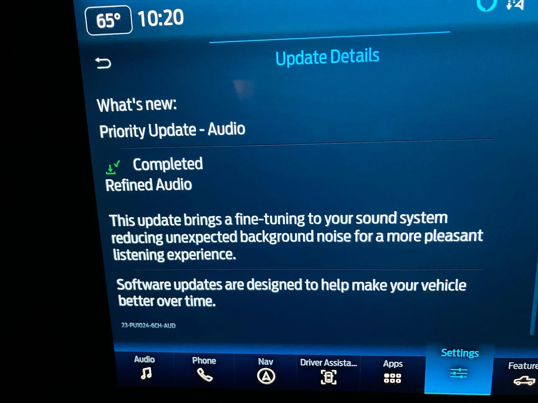

You can look on both FordPass app under updates and also on Sync under Updates.
My truck was updated 8/7 and I noticed the issue on 8/9. Not sure if I drove it between.
Might need to call the dealer.
My truck is a2023 Lariat with 502A pkg.

Latest update.
Local dealer said "maybe use a USB cable instead?" Not going to them anytime soon.
Call Ford Sync support rather than do a factory reset. She said "your truck should have received an update that should have fixed this issue but it clearly isn't working, so take it to a dealer and maybe they can force the update again. DO NOT do a factory reset of Sync"
