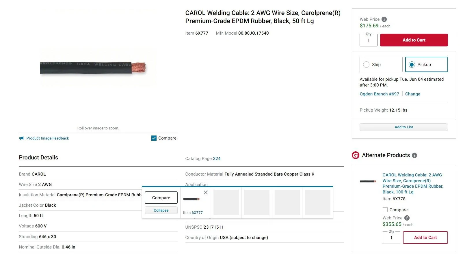

is this the wire I'm looking at for the power cable? I'm thinking it's what I have
Ford F-150 winch to battery connection Screenshot_1-6-2024_162158_www.grainger.com

Audio shop would have the type of fuse holder you need. Some big amps get fed off fat power cables. They should have the wiring too.
