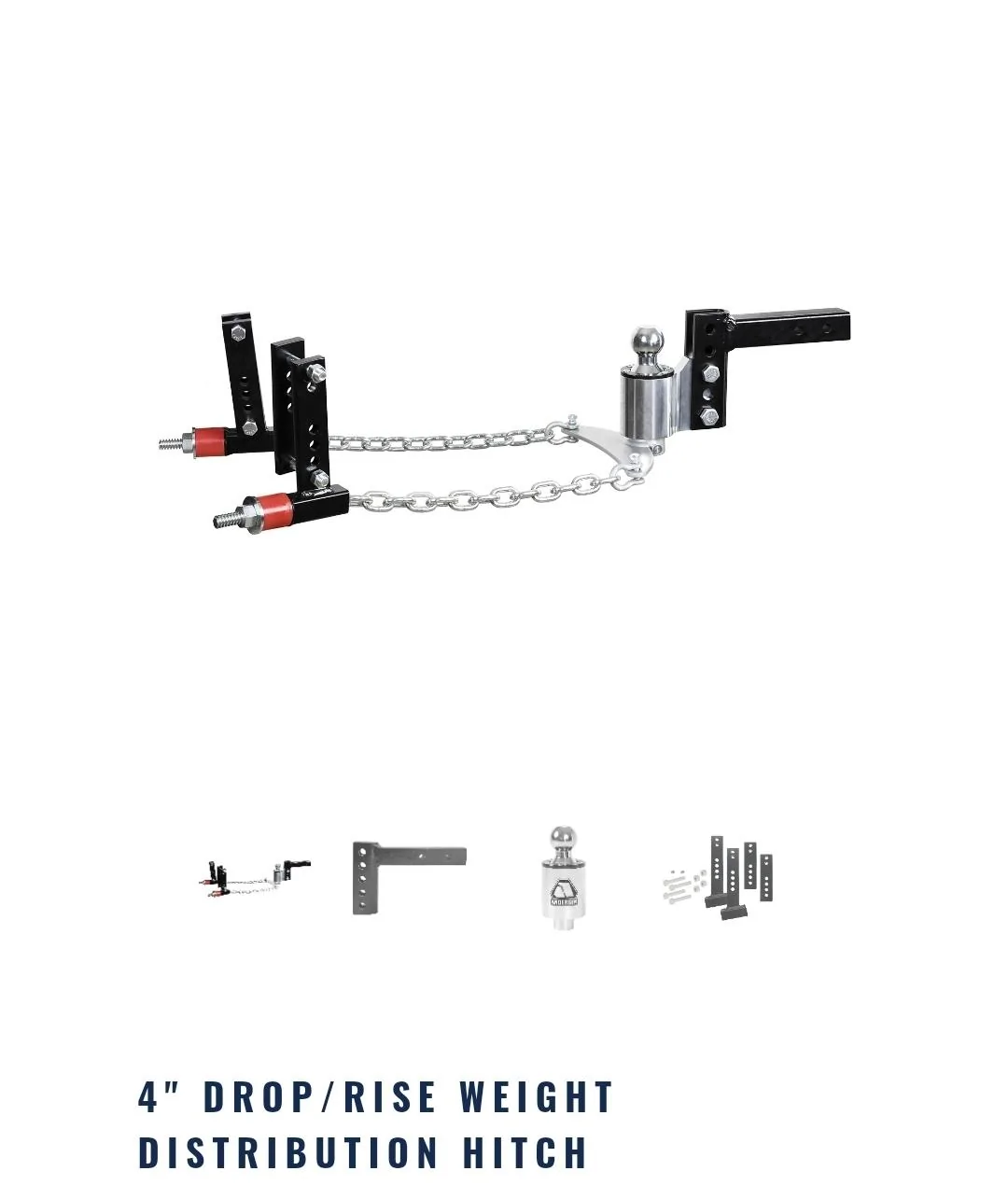

For a smaller trailer look at the Anderson WDH. Takes a little getting used to but is easy once you have it figured out. Only about 60 lbs instead of 100 lbs like the friction bar style. Its adjustable based off load and you can dial it in really well. A little expensive but you don't have to deal with the bars. I use the anderson for my WDH and like it alot. You can back up without disconnecting and has sway control.
Ford F-150 Who actually uses a weight distributing hitch? Screenshot_20210504-221832_Chrom
Just remember if you are buying a WDH with friction bars you need to know your tongue weight
