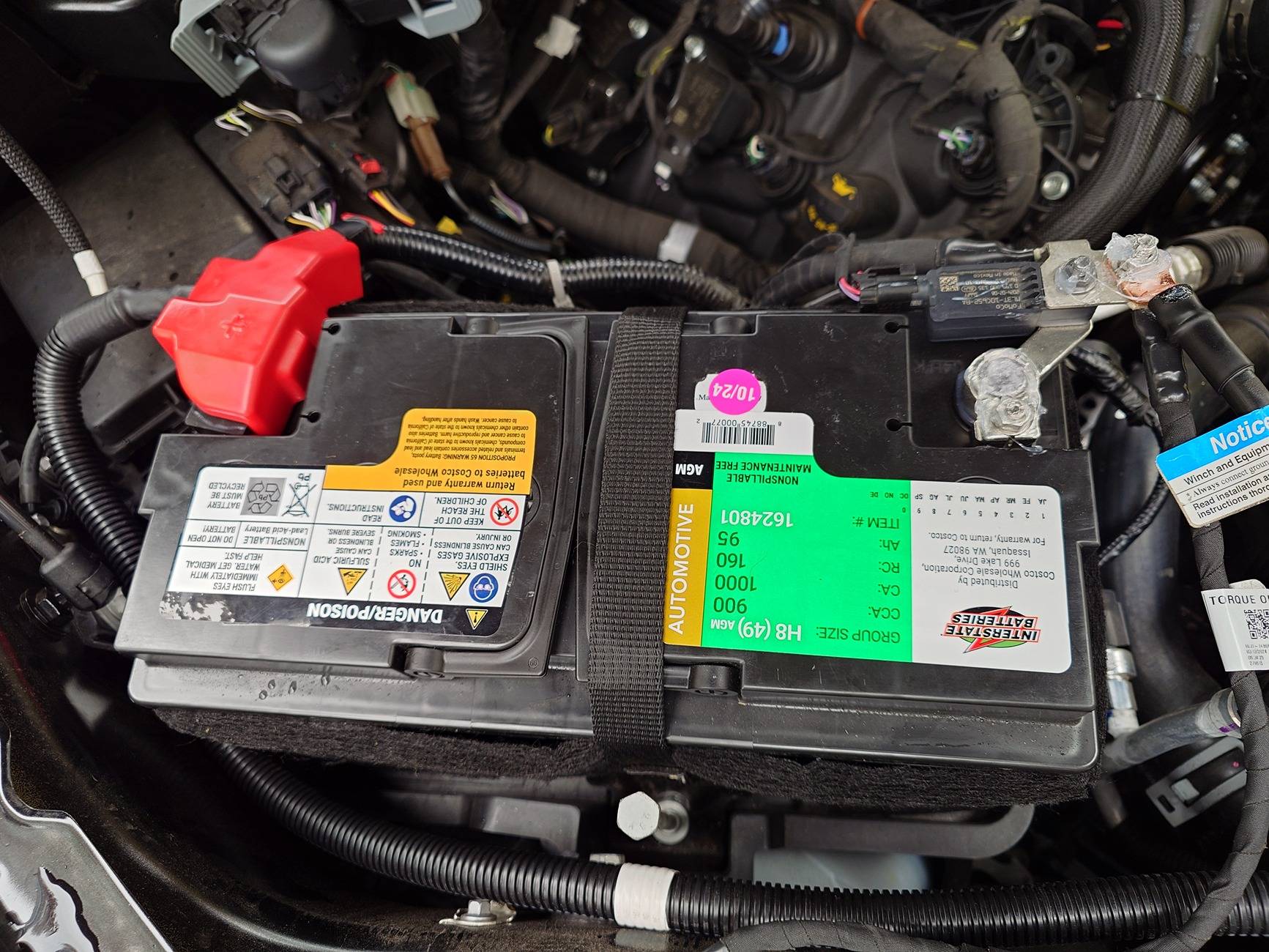

Costco H8 installed.
Perfect fit. No hassle at all.
I did the BMS reset procedure. I went into Forscan to see if I needed to update the BCM settings, but looks like 14th gens don't need it.
I added the OE Ford H8 blanket as well.
From 80 Ah/ 800 cca to 95 Ah/ 900 cca.
This upgrade gives me better piece of mind while out remote.

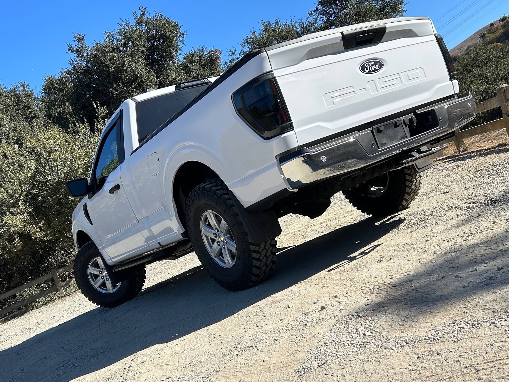

Parked it on some dirt and took a few photos.
Some gloss black, raised, F-150 inserts for the tailgate will put the cherry on top for the stormtrooper set up. Maybe also look for a set of BAP rims that someone might be selling cheap and that would be an extra "look".
Looks great!
