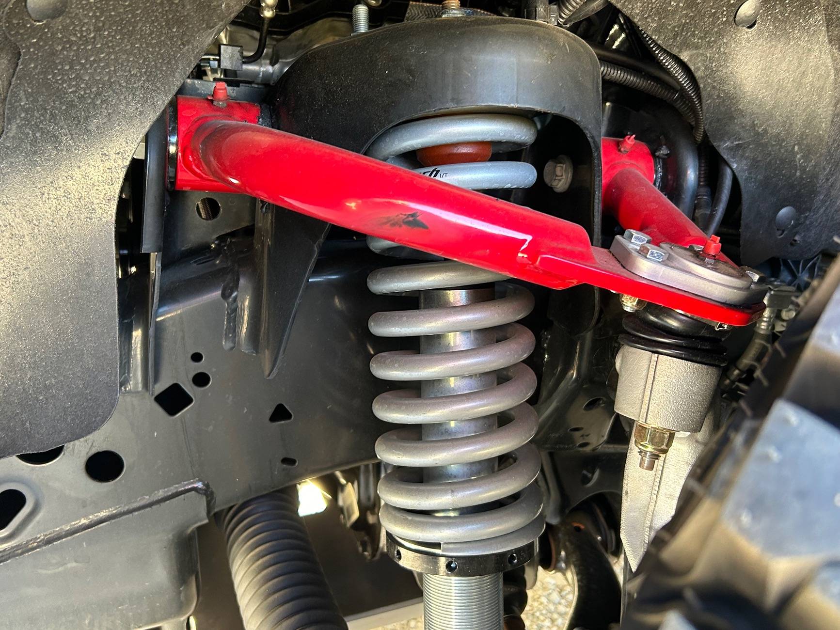

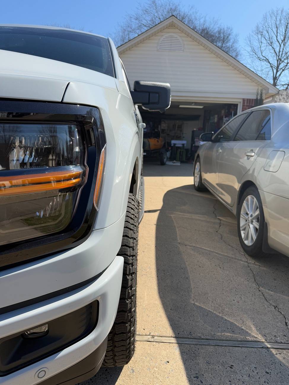

FWIW I have the EP2 kit as well but went with JBA UCAs. Bushings and BJ are easily greaseable so no squeaks and the BJ can be replaced without a press or removing the UCA. But they are beefy so my tire rubbed with the stock +44mm wheels before I added 1/2” spacers.
