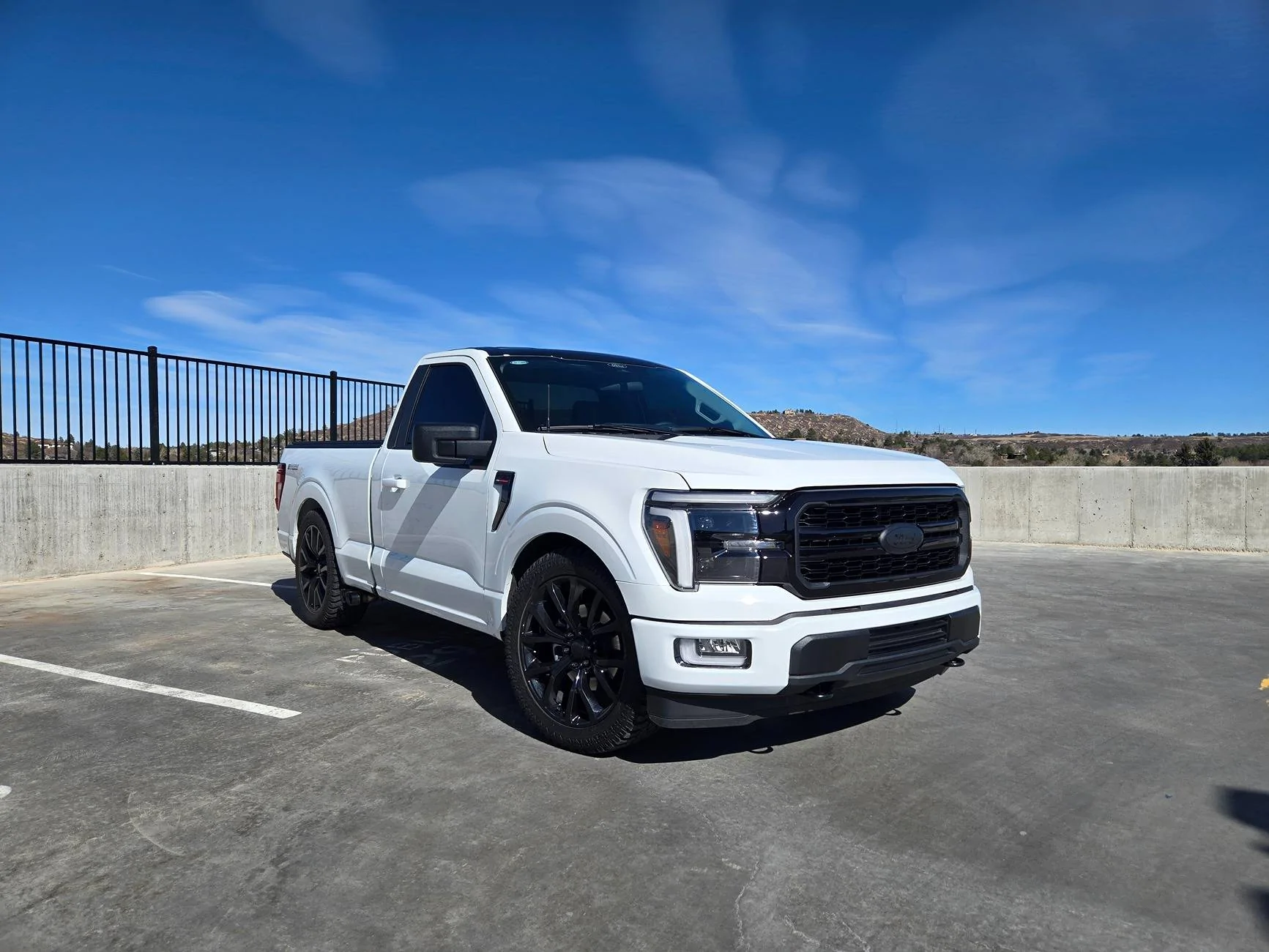

lariat OEM front end finally installed was a pain for wiring but it was worth it anyone else have a higher trim front end on their single cabs?
I just finished mine. Install was smooth and wiring was flawless with Ryan's harness. Ran the wires into the cabin via the side vents hole. The entire process was very easy. The hardess part of the job was removing the bumper bolts. Very very easy with the harness. Here is a pic:
Ford F-150 Lariat Front End (on Single Cab F-150) Finally Done! IMG_0423.JPG
