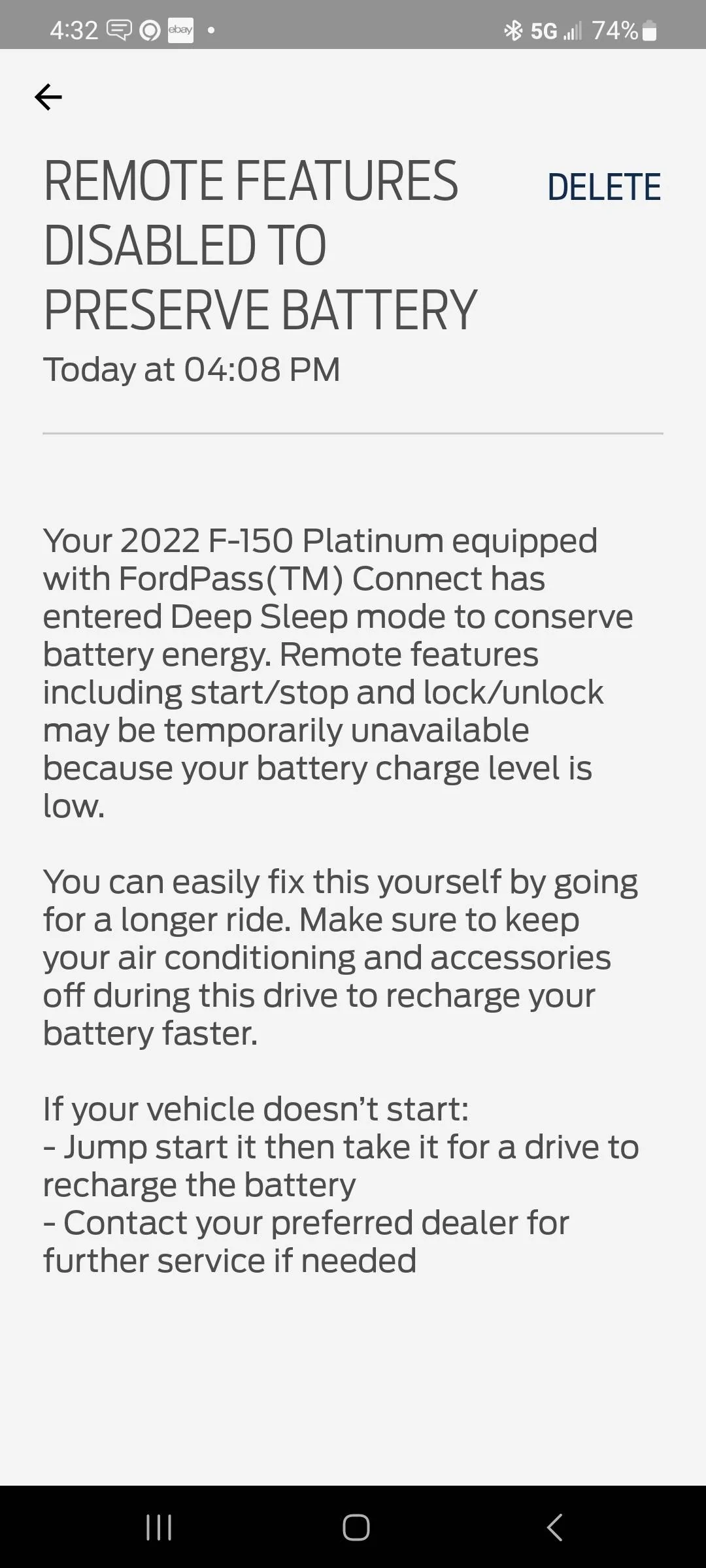

Ok well it's getting more and more confusing....
Disconnected trickle and had to run to the bank and this popped just as soon as I DCed the trickle charger.
Yes I am running AC and cooling seats.... But....

Ok so I "reset" the truck, both batteries disconnected for over an hour. Still no lights and I just noticed that on my ZONE LIGHTING on my FordPass App, it wont even turn on manually. I am getting this error.
