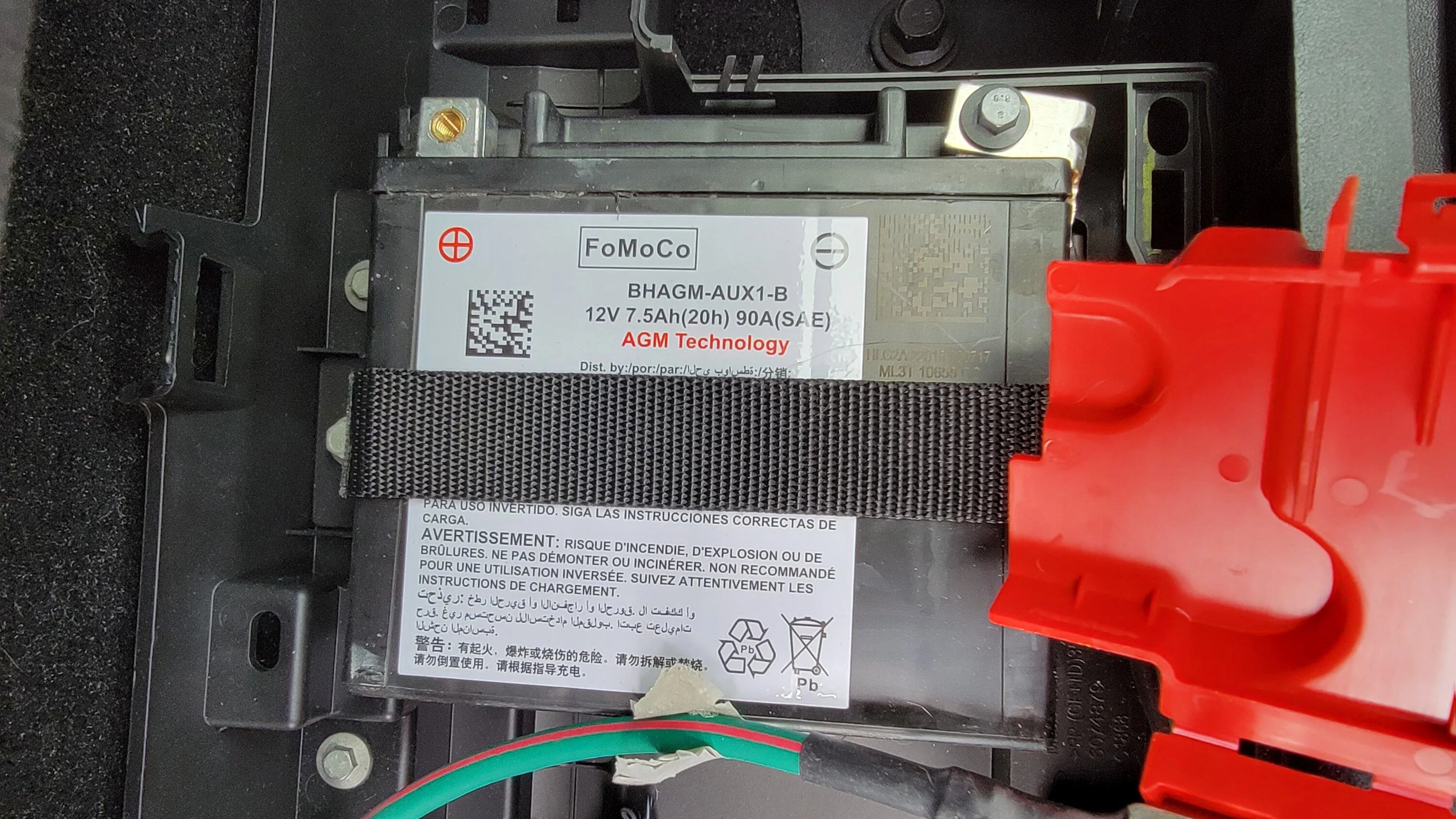

Ok Hamma, Im resetting now as we speak. Is this second little battery what my truck runs off of in "Electric" mode? Sorry for my naivete. But that cant be right can it?
Ford F-150 Welcome lighting not working anymore... 20230427_110608
It uses both batteries 99.9% of the time. The little batt powers the electrical systems for less than a second when the starter is turning. Since the DCDC is still running, the battery is really nothing but a buffer for transient spikes. It provides a little additional storage capacity to the under-hood batt, but not much. Combined they're somewhere in the 100ah range but only 50ah usable. Since the truck considers 80% full, there's only 40ah of usable capacity, but after only 10ah of that missing the truck goes into low batt mode. Without any appreciable run time the batt is likely at 75% or so and as little as 7ah getting used triggers low power mode.
