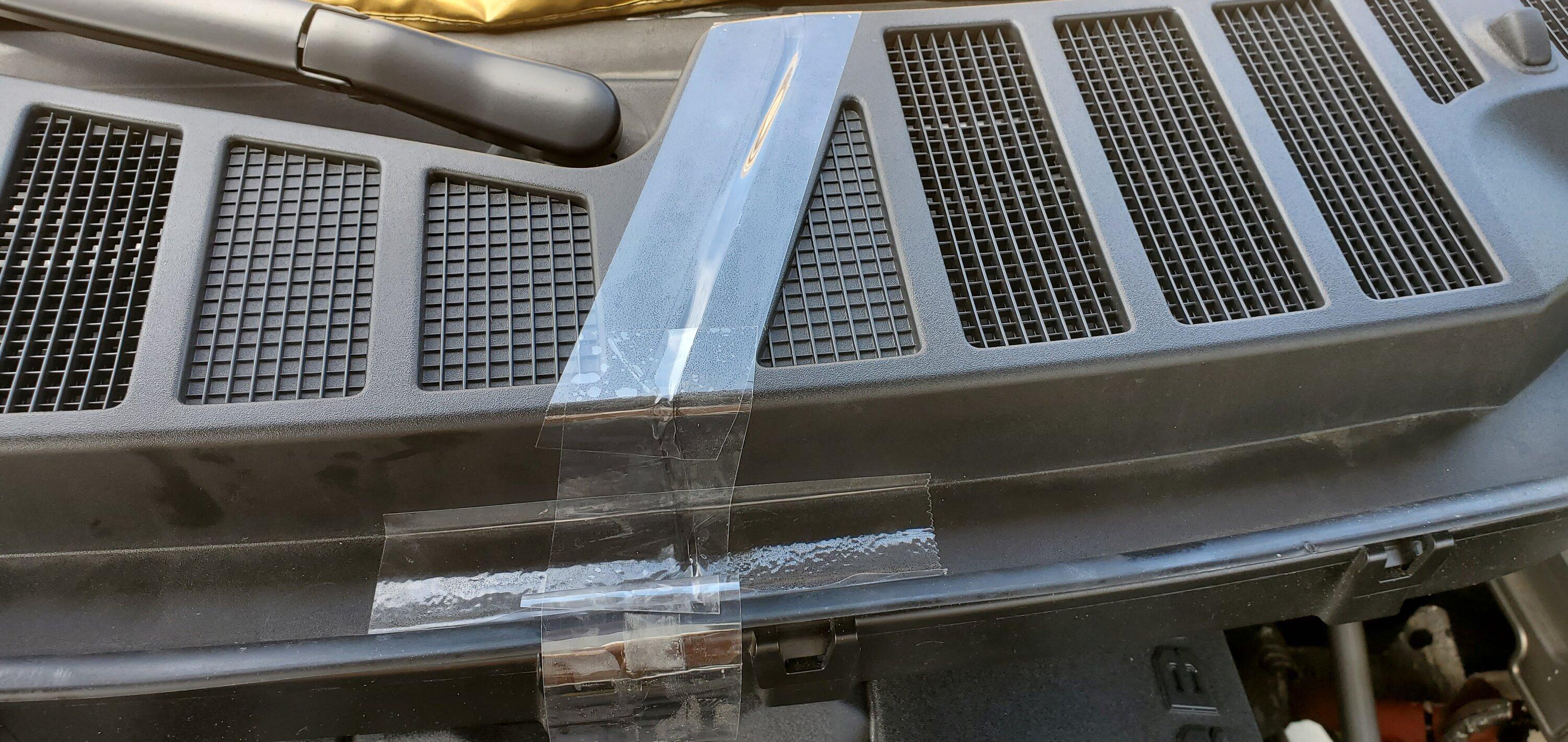

Was at the dealer to get the leak stopped. They would not because Ford says there is no fix and they will not pay for it. The dealer even did it with other f150sand it leaked. I took some PROFLEX RV CAULK CLEAR Ane ND sealed the entire seam between the wiper schroud. Be sure to unhook the clips holding the driveers side and lay in the caulk on the passeger side all the way to the engine side lip. Cauking the entire length. Lower the drivers side panel clicking it into place. Then lay in a bead along the channel between the panels. Use painters tap to keep the caulk off the top of the panels and making a mess. Use rubber gloves. Let the caulk dry for a few hrs before removing the painters tape. It rained a couple of hrs after i did this. Not a drop of water on the engine cover. Photos attached
Oh my, this looks awful
