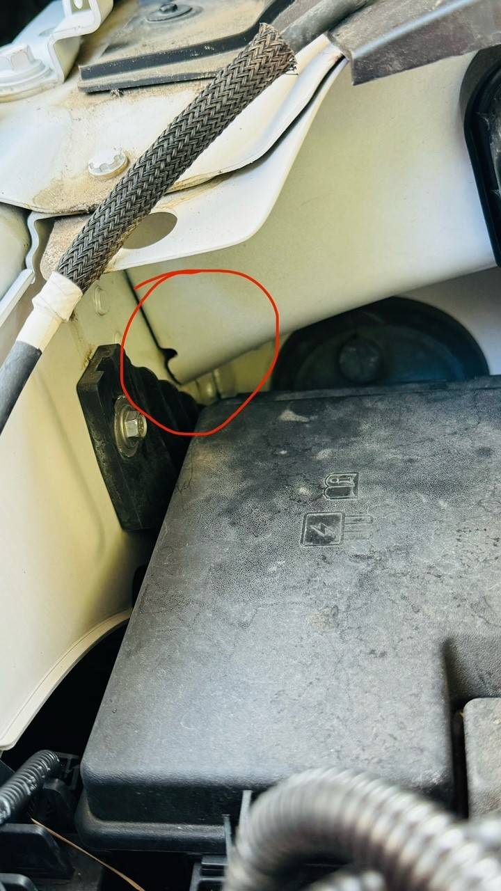

anyone figure this out... i been deployed in japan for 6 months my buddy has been watching my truck... every strong rain passenger side carpet completely soaked.. literally standing water in the channels under the door. cant seem to replicate it or find the source. seems dry where you would think it would have to be wet for water to get there. and its JUST there no where else. Firewall seems dry as well looking back at it from the front over the battery area. maybe the antenna wire? running along it? i hate this...
The drain on the passenger side cowl gets clogged up due to it being a piss poor design. When clogged up water will make its way into the fresh air inlet for the HVAC and saturate the cabin filter then flood the passenger side carpet.
You need to use a coat hanger or other thin wire to clear the two holes (one on the front and the other 90 degrees from it on the bottom) as well as the slot that's between them. Had this same thing happen to mine and Ford considers this a maintenance issue and will not cover it under warranty despite there being absolutely no documentation anywhere that this drain needs to be cleared out regularly.
