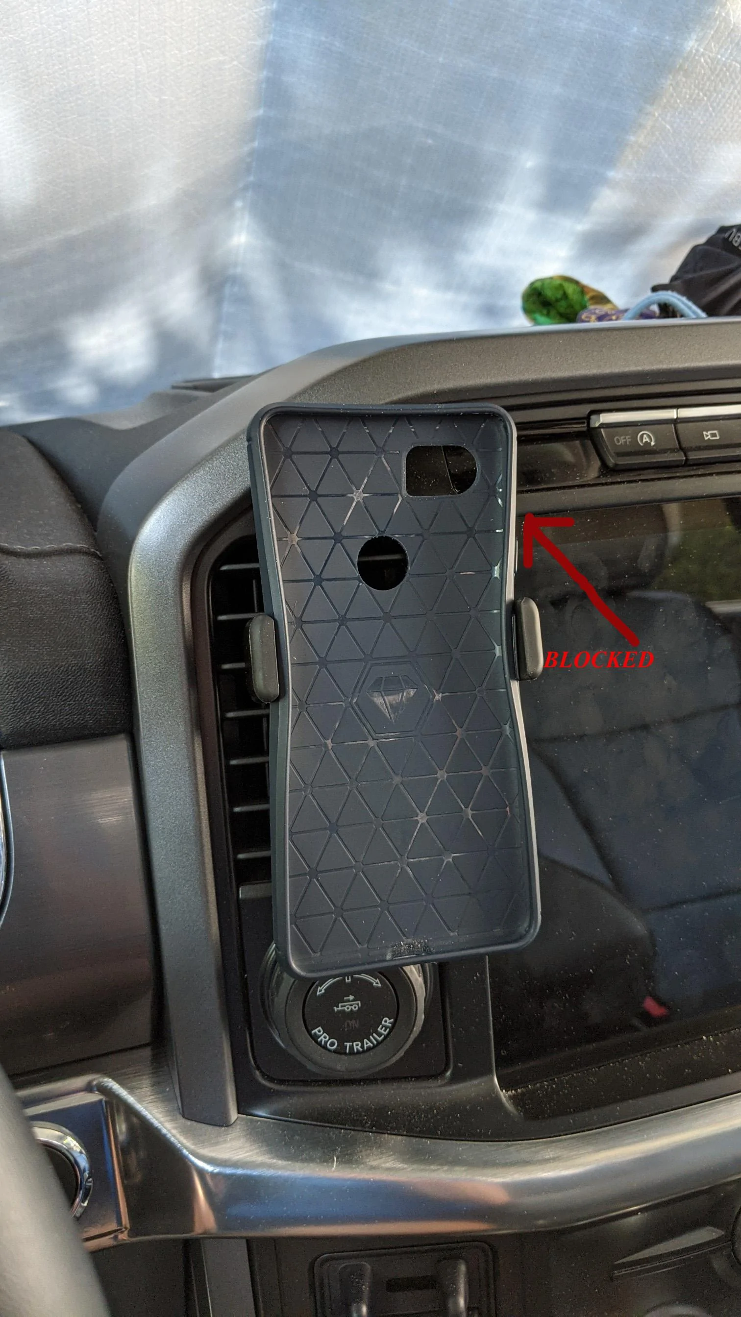

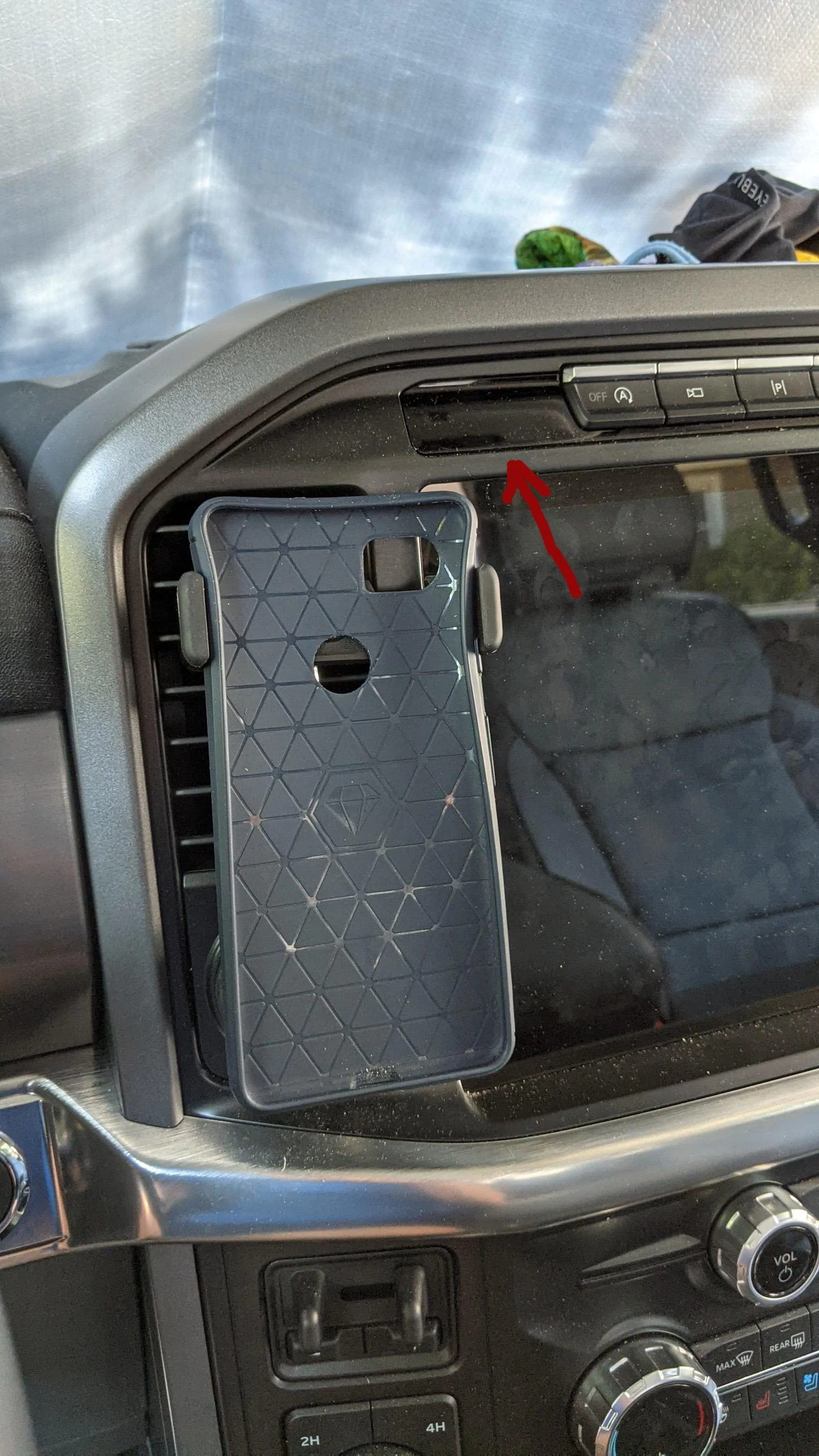

Just took 1st road trip with BlueCruise active. After I figured out what was causing driver monitor camera problems, all worked fine even in heavy traffic from LAS to LAX. I assumed the driver monitor was on the door post, but turns out there is also a driver monitor camera on center dash that I was intermittently blocking with phone set to Waze to back up Android Auto. Here are View attachment 51712 View attachment 51712 pics showing problems.

Thank you, that totally explains why I initially had problems. My local dealer BlueCruise update was excellent without any problems. It helps that the service person was totally tech savvy.
