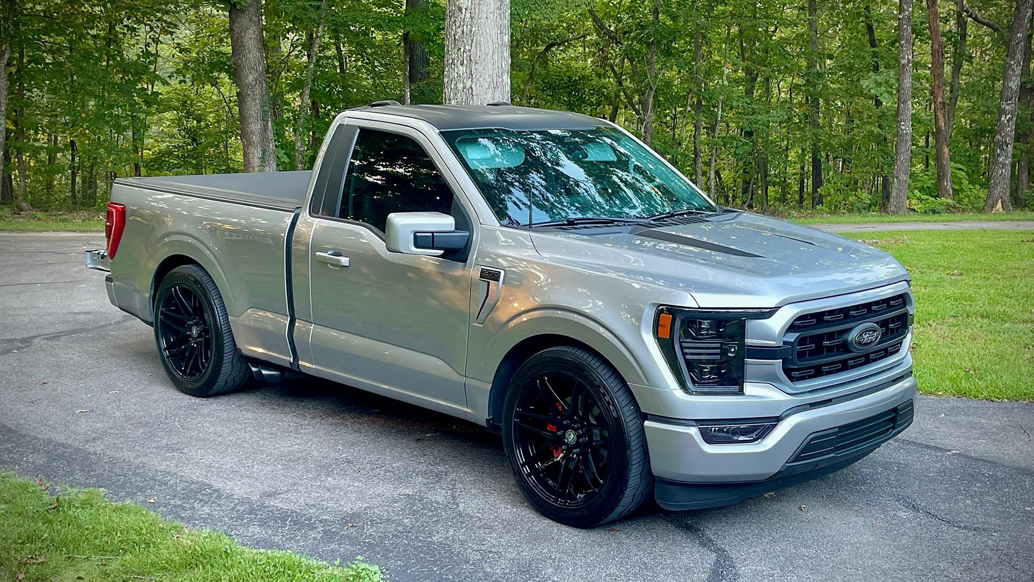

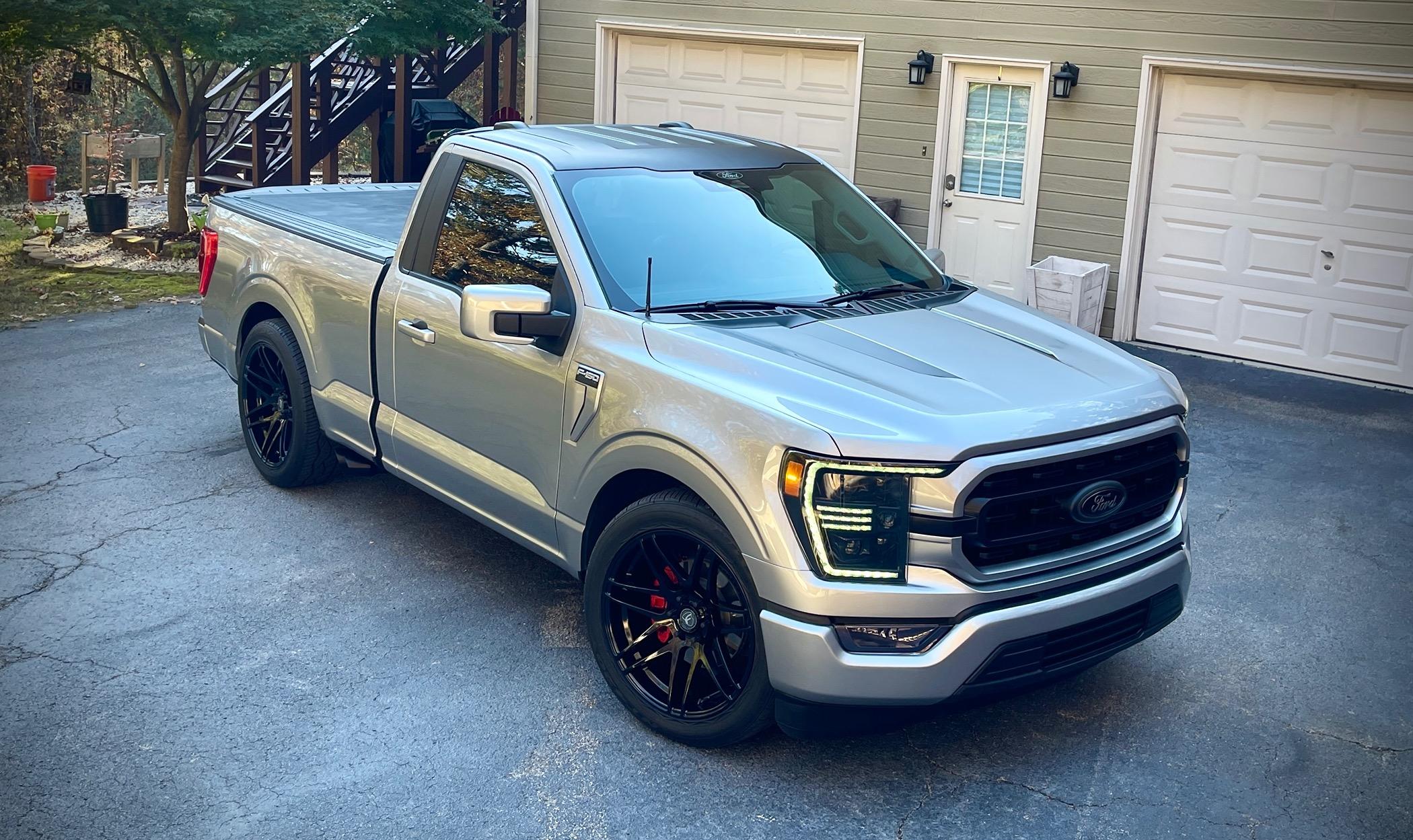

l wanted led but didn’t want to buy a expensive harness to upgrade to the oem leds . So I went with these AlphaRex which come with halogen but put LEDs in them . I like the fact that I can change the bulbs my self vs the high end ones if led goes out yo need a whole new housing. For the money these are hard to beat. They have halos and Cornering lights when you use the blinkers. $ 557. At Realtruck right now. Fit and finish is really close to oem . Packaged really well . Easy with YouTube install videos.

Ford F-150 Upgrading 2022 F-150 STX halogen headlights to LED head lights? IMG_6109
Ford F-150 Upgrading 2022 F-150 STX halogen headlights to LED head lights? IMG_5913
