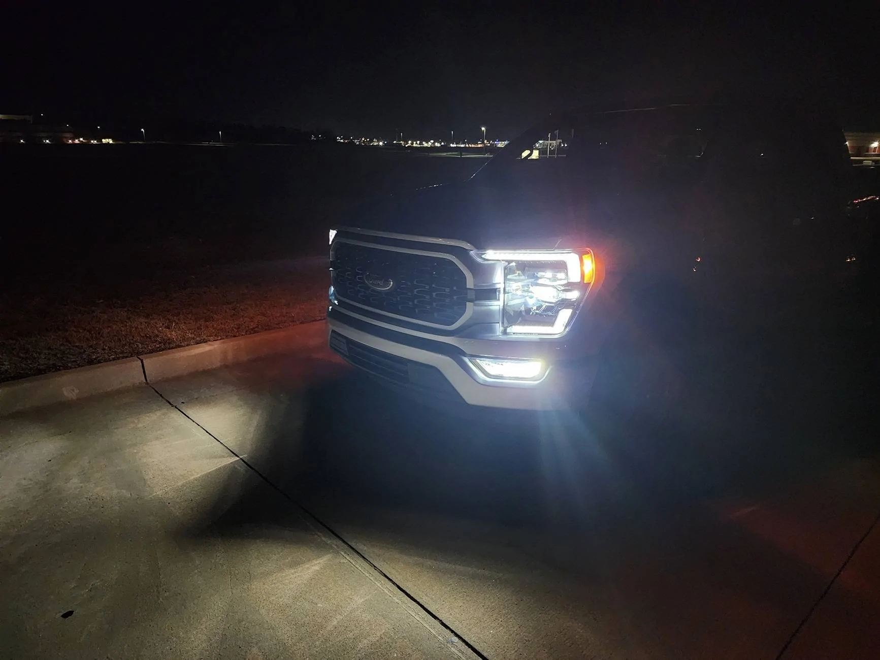

x2 on the aftermarket headlight upgrade! Upgraded my STX with halogens to Morimotos.
Ford F-150 Halogen upgraded lights or led headlight upgrade on 2023 STX 20230304_202003_resized
