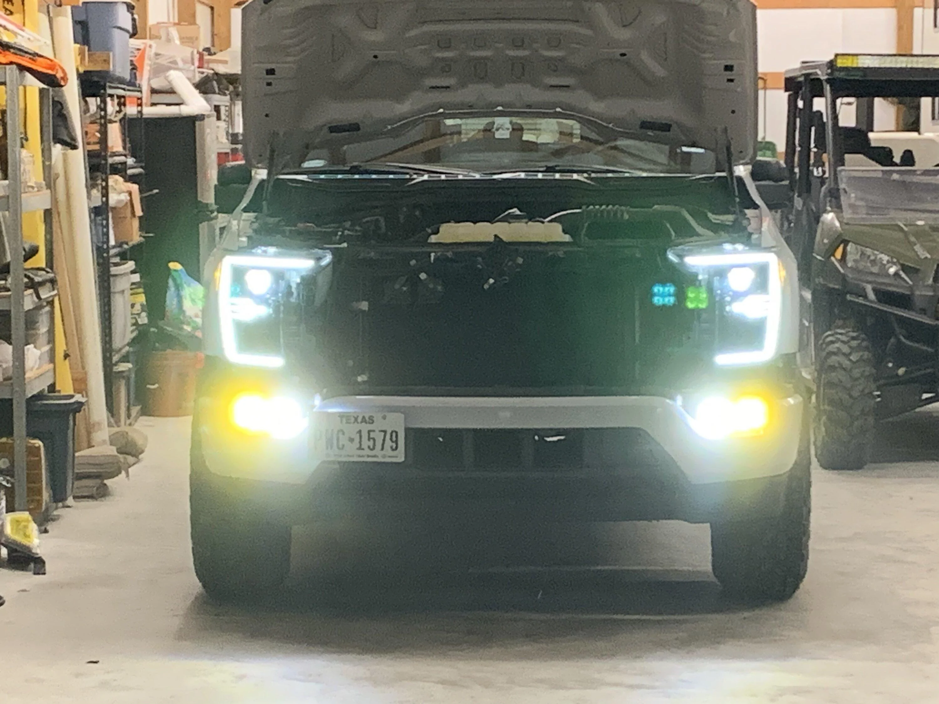

I just did the bulb conversion with some LED Headlight bulb replacements, I got offered to review. seem pretty good to me. There is the bulbs, then the difference, then the full outcome of the swap in the photos below.
Ford F-150 2023 Halogen to Led Headlights Lights in box
Ford F-150 2023 Halogen to Led Headlights Led VS Halogen
Ford F-150 2023 Halogen to Led Headlights Led full swa
