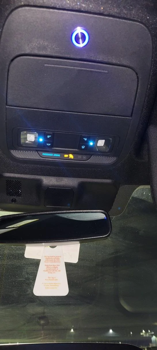

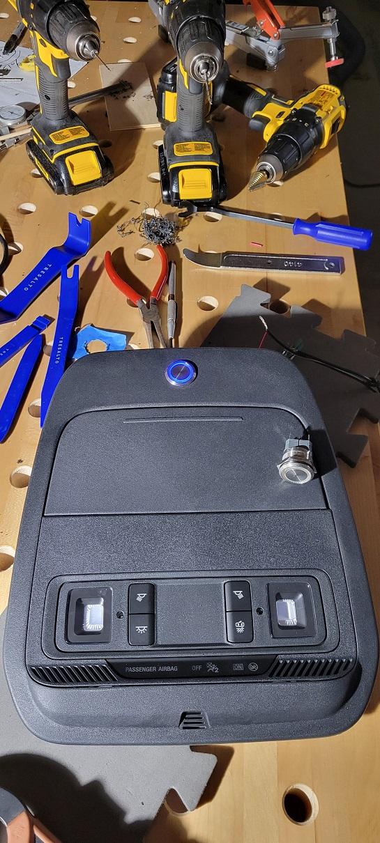

I almost bought this Great 4 or 6 switch panel for the overhead console from KustomFX LLC, but only needed one switch. So I ran a 6-conductor, 18-gauge cable just in case I wanted to expand some day. I also drilled my large 22-mm illuminated pushbutton switch where I could cut out further in the future if I ever decided to install this professional panel from KustomFX.

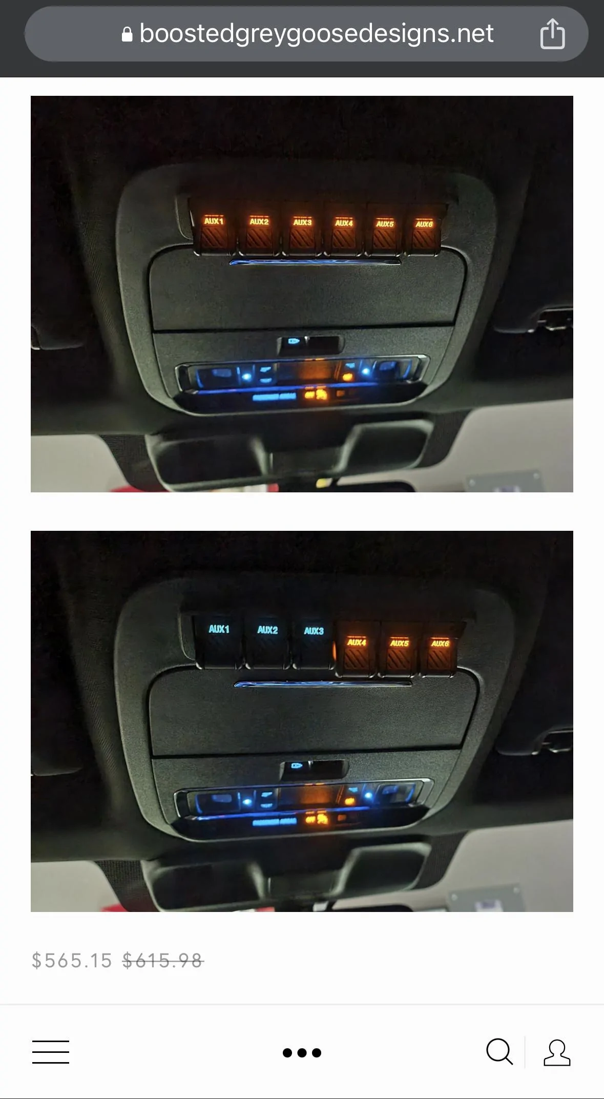

A well known aftermarket upgrades guy has released his version which has everything but the console itself.
So glad he released it, finally!
It’s pricey but I unfortunately don’t understand enough how it all works to even attempt to try myself. I’m curious as to which relay he’s using. I’ve been told the F150 one is part of a larger harness but the super duty one is standalone.
I agree it is pricey, but always worth it tbh! Lawrence (he owns that site and deal with him personally), he always makes sure the harness is plug and play with little pain as possible, just like his LED tails harness and folding mirror harness (adding after the fact for XLTs). If you'd like, I would contact him through the site "Contact Me" and see if he give you more details about it or message him through Facebook. I did place an order for these, need that so bad compared to putting holes for rocker buttons switches on the dash/trim pieces lol; want the cleaner oem look!
Do you know which console you need? I got fairly acclimated with the consoles and it’s crazy how many variations there are.
