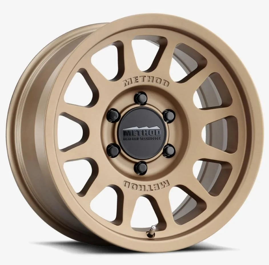

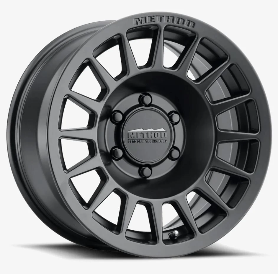

17x8.5 MR703 with 0 offset / 4.8" backspacing18x9 MR707 with +18 offset / 5.7" backspacing
Ford F-150 UPDATED: Help me decide: 17" or 18" Method Wheels MR703 17x8.5 0 offset
Ford F-150 UPDATED: Help me decide: 17" or 18" Method Wheels MR707 18x9 +18 offset

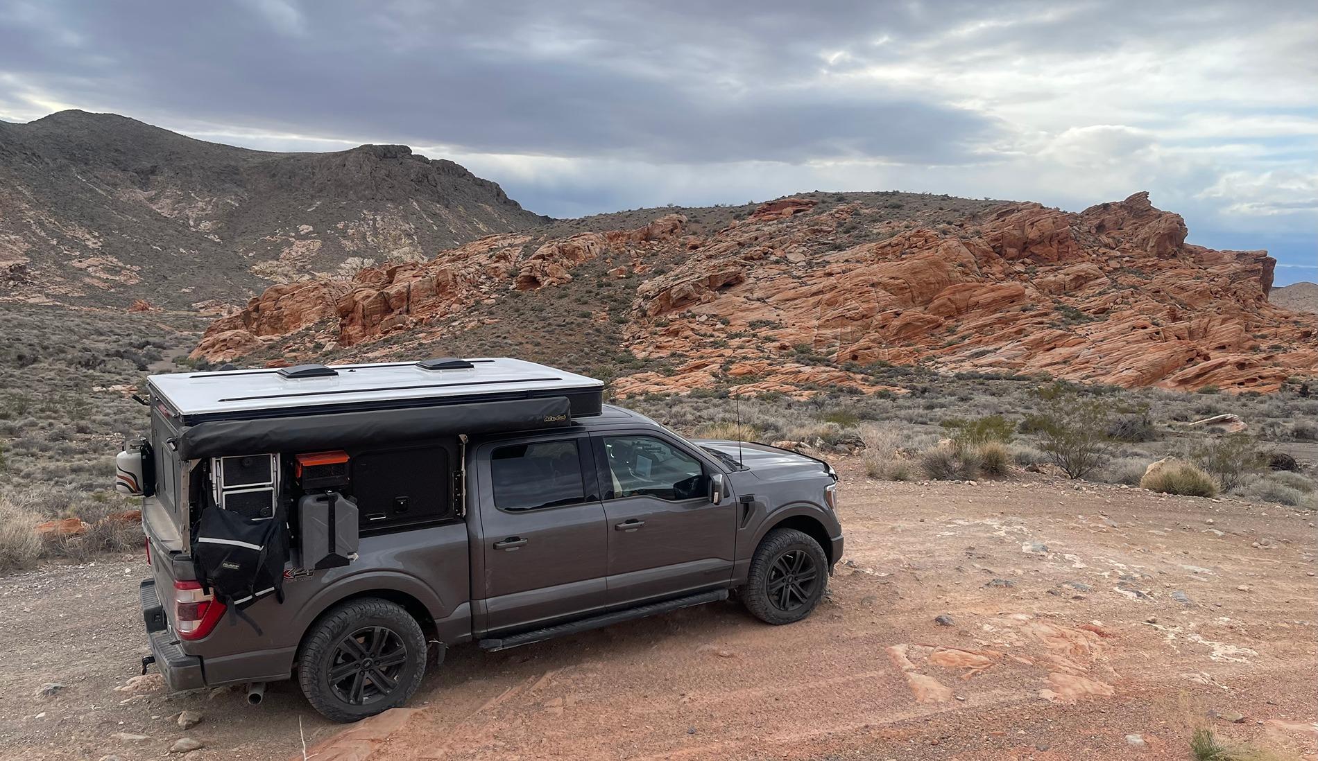

Here's my current setup, in case you're wondering:
Ford F-150 UPDATED: Help me decide: 17" or 18" Method Wheels GoldButte

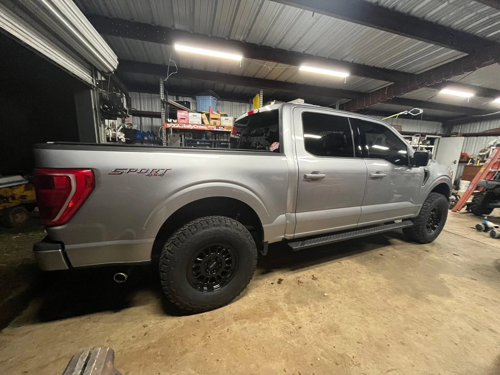

For off roading and not towing, if you want to go with greater than 34" tires go with 18" wheels.
If you are going with tires less than 34" go with 17" wheels.

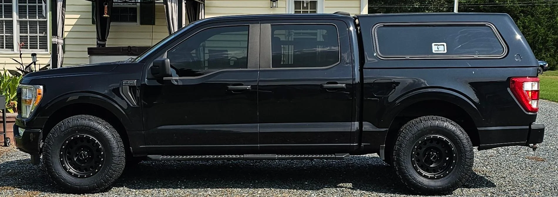

I went with 17’s. Prefer more sidewall off-road
I definitely like the look of your 17s. And it does look like you've got a lot of sidewall.
How come you didn't get a larger tire? 285/70/17 are slightly smaller than stock even.
It was a great deal on the wheel/tire combo. I may look at something bigger when it's time to replace the rubber.
