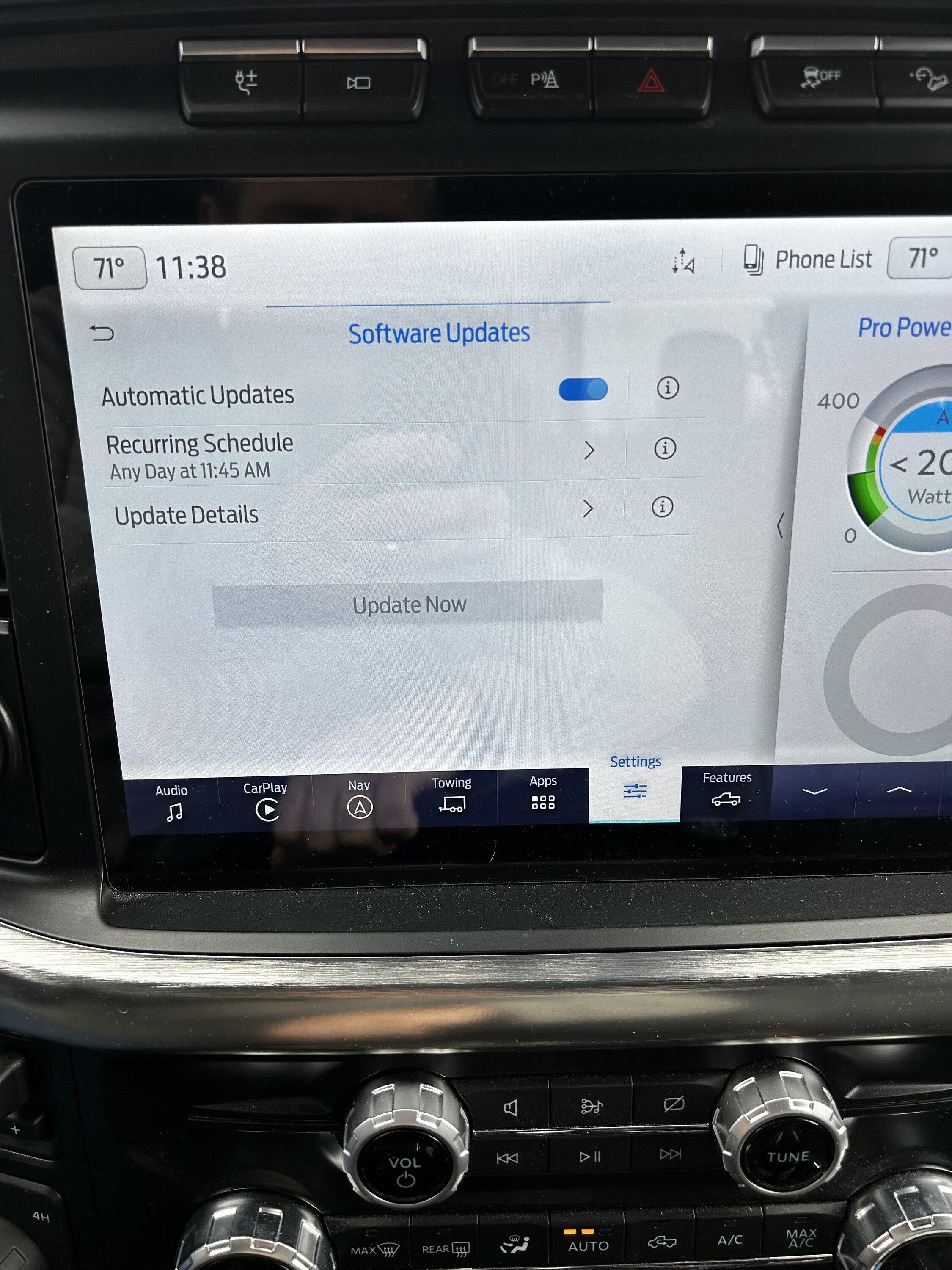

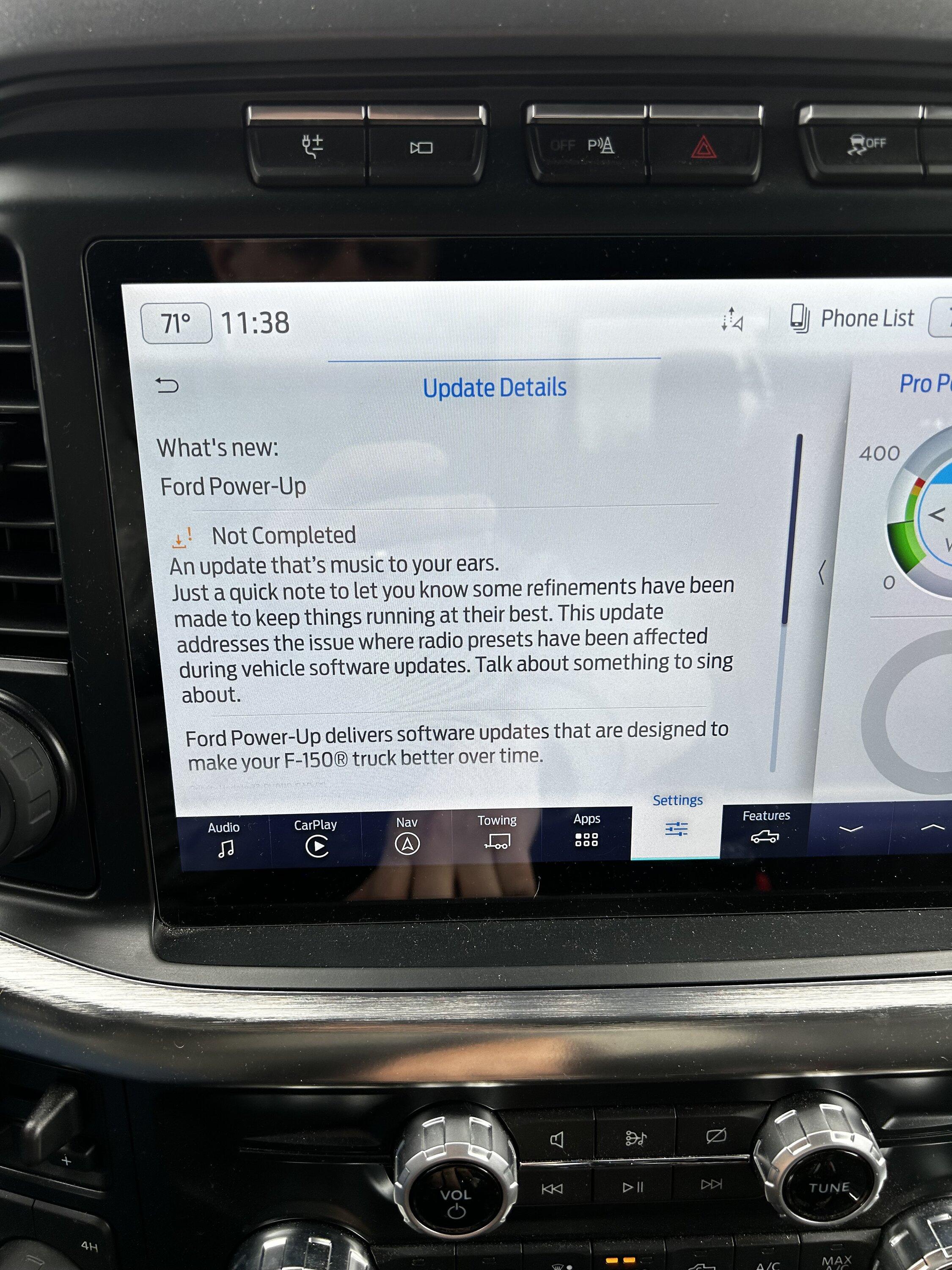

I had an update that was trying to install every day, ford pass kept showing it being rescheduled. I assumed it was failing for low battery and already had an appointment to test/replace the battery so I left it alone to see if it would run after. New battery was installed and it’s no longer even trying. If I go into the menu no option to update now but update details shows an update not completed. How to I get it to run or see why it’s not?

Post in the VIN lookup thread.
Most likely your OTA trigger ran out and the update will get sent to your truck again eventually.
11:45AM seems strange auto update time. I have mine at 6PM since I'm usually home by 5PM battery is good and charged at 6PM for updates.

It’s normally set at 1am, I changed it to 11:45 to try to update while on the battery charger. In the past the only way updates would install was if I had it on a charger.

The OTA was queued up for your truck twice in the same day. It went through the first time, so it failed the second time because the update was already applied. You can disregard the failed message.
