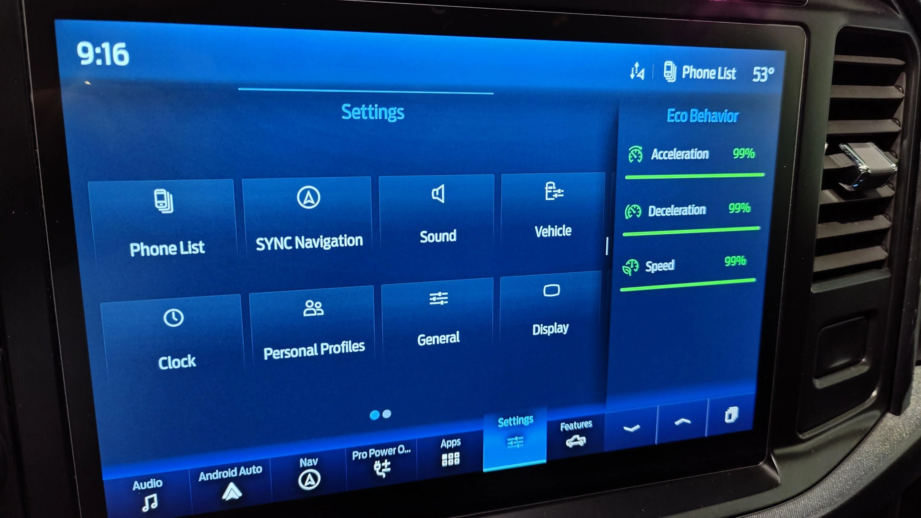

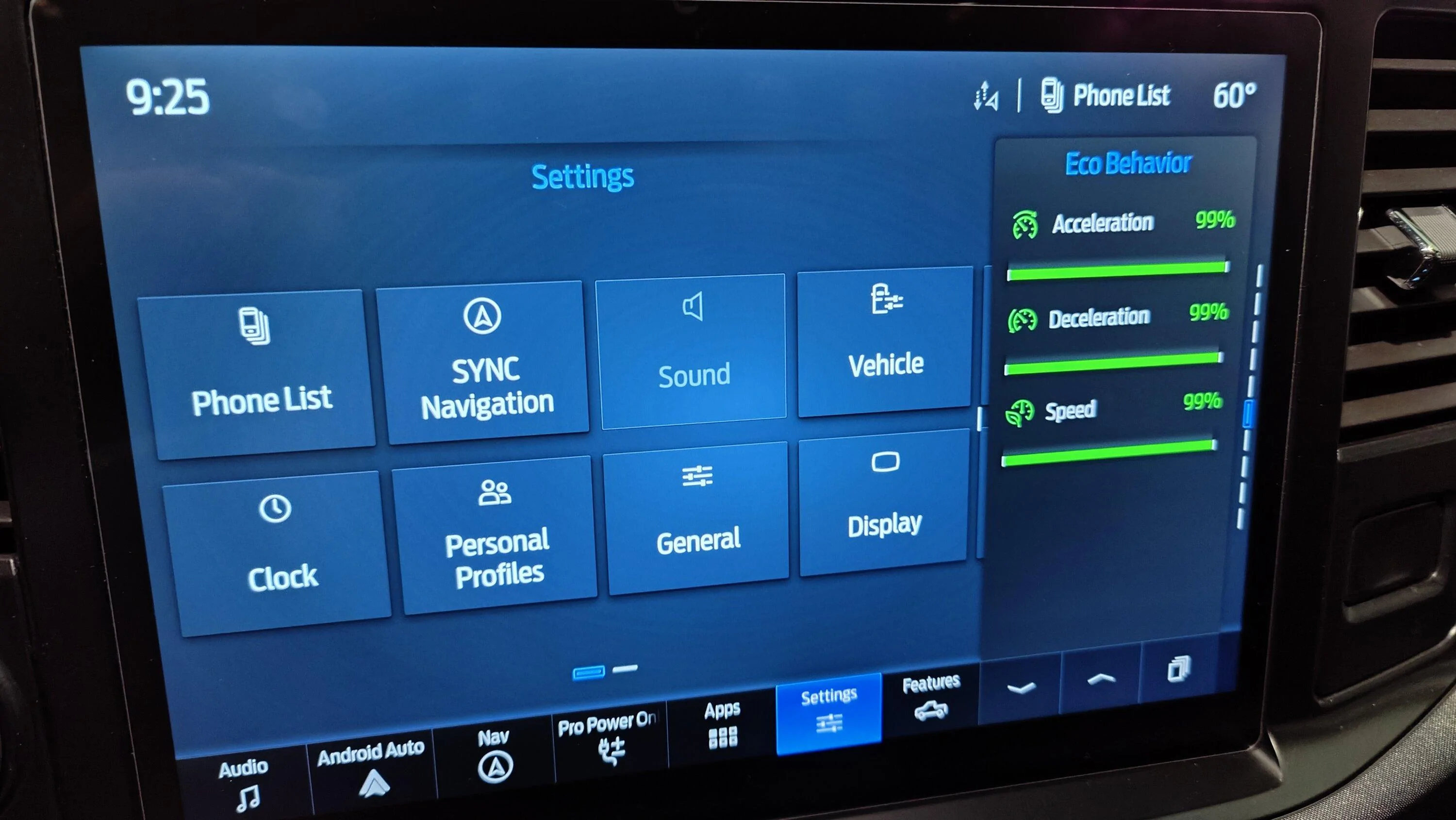

I finally turned on the unreal theme. No temp controls of 75rh logo, I just wanted the unreal. I wish I had taken more before pictures, I could always undo it.
I hate to be vague like everyone else, but everyone else is right, it's subtle and you have to see it in person and in motion to really get a feel for the difference.
Here is a Before
Ford F-150 Unreal Theme/75th Anniversary Splash/Climate Controls IMG20230214211611
And after (Unreal theme)
Ford F-150 Unreal Theme/75th Anniversary Splash/Climate Controls IMG20230214212542
You are on one of the more subtle screens though
Oh, I figured a screen with a lot of text would have been good.
I made the change, saw it worked, took that pic and then went back inside, I didn't even really play around with it.
