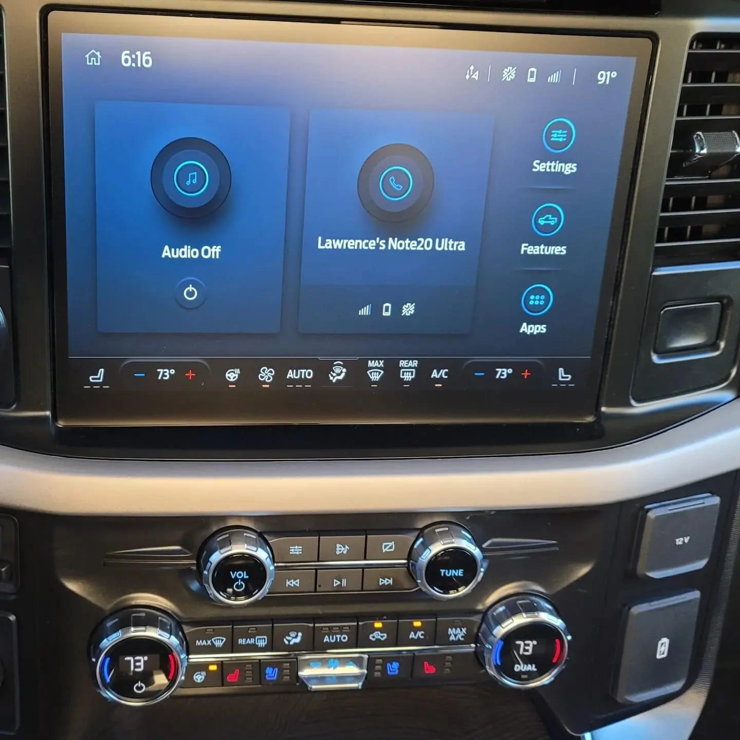

So let’s see if anyone has this issue and what to do to fix it.
Below is my work 21 XLT (SYNC 4 version: 22192) that has been changed for unreal theme. Apparently this is the wrong look, the correct one is the 2nd picture below the first.
Ford F-150 Unreal Theme/75th Anniversary Splash/Climate Controls 1973C785-032E-4AB5-8900-4D4BDAC6FD69
This second picture is from my good buddy Lawrence from Boosted Grey Goose Designs and well by now everyone knows that company. Anyways, his is updated to the new sync unreal theme like mine but the proper way and the way it’s supposed to be, see below (his is one version behind me I believe: SYNC 4 version: 22082):
Ford F-150 Unreal Theme/75th Anniversary Splash/Climate Controls 4522AB8F-AD62-45AE-947D-03FB8961A8A2
Has anyone had the same issue as me and isn’t getting the proper real engine theme like the second picture, still stuck on the first? If so, what’s the proper way to fix this to get this?

You have unreal engine enabled. You do not have the wrong look or improperly done. The only difference is that he has the climate bar enabled. Once you enable the climate bar, It changes the layout to what he has. Looks nice but its honestly a waste of screen to have all of the hvac controls and a big box for your phone and a big box for audio. If you use your phone for audio it really just waste the entire screen.
Thank you for this! For a moment there I thought I missed a digit or something somewhere.
—Question; he recommends to enable all options from like 52-56 on the FORScan spreadsheet (main) like he did, would doing this enable what he has to achieve the same look as his; just a thought?

@Nightshade what do you currently have at 7d0-02-02

So I ended up having to go back in after I did the updates and turned on the unreal theme. To get the climate bar at the bottom make sure you have 7D0-02-02 set to the right value for your truck. I did both the unreal and climate at the same time and didn’t bother to check when the climate bar wasn’t at the bottom. I had to go back in and change that to get it on the bottom and get the different Home Screen like you are looking for.
