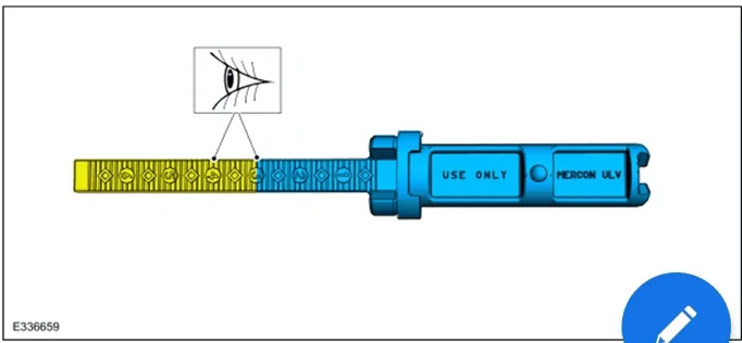

My transmission had a leak between the transfer case the transmission, which took multiple trips to the dealership to get repaired. Through that process, I checked the fluid level many times. You will need to wear a long sleeve shirt and gloves given the location. Practice taking the plug out and putting it back in a few times before you check it when it is warm. I also had to pull the plug out a few times and put it back in to get an average reading because each time I read it, I got a slightly different level.
My approach is to lay a tarp down on the driveway, have all of my tools ready to go along with a rag next to the tarp, so I could pull the pickup on the tarp to quickly get the plug removed and check the level. This is a pain with the PowerBoost because it will shut down fairly quickly. Setting the drive mode to tow and setting the HVAC blower to 5 didn't help.
Although I didn't trust the dealership to measure the level correctly, they did have the level set correctly.
There is no cold temperature check procedure that I found with a lot of searching. Also note that you need to lookup the correct level indicator for your engine.
2021 - 2023 Ford F150 PowerBoost
Ford F-150 Underfilled Transmission Fluid - Has This Issue Ended? 1718847384453-x
2021 - 2023 Ford F150 5.0
Ford F-150 Underfilled Transmission Fluid - Has This Issue Ended? 1718834927715-nl
