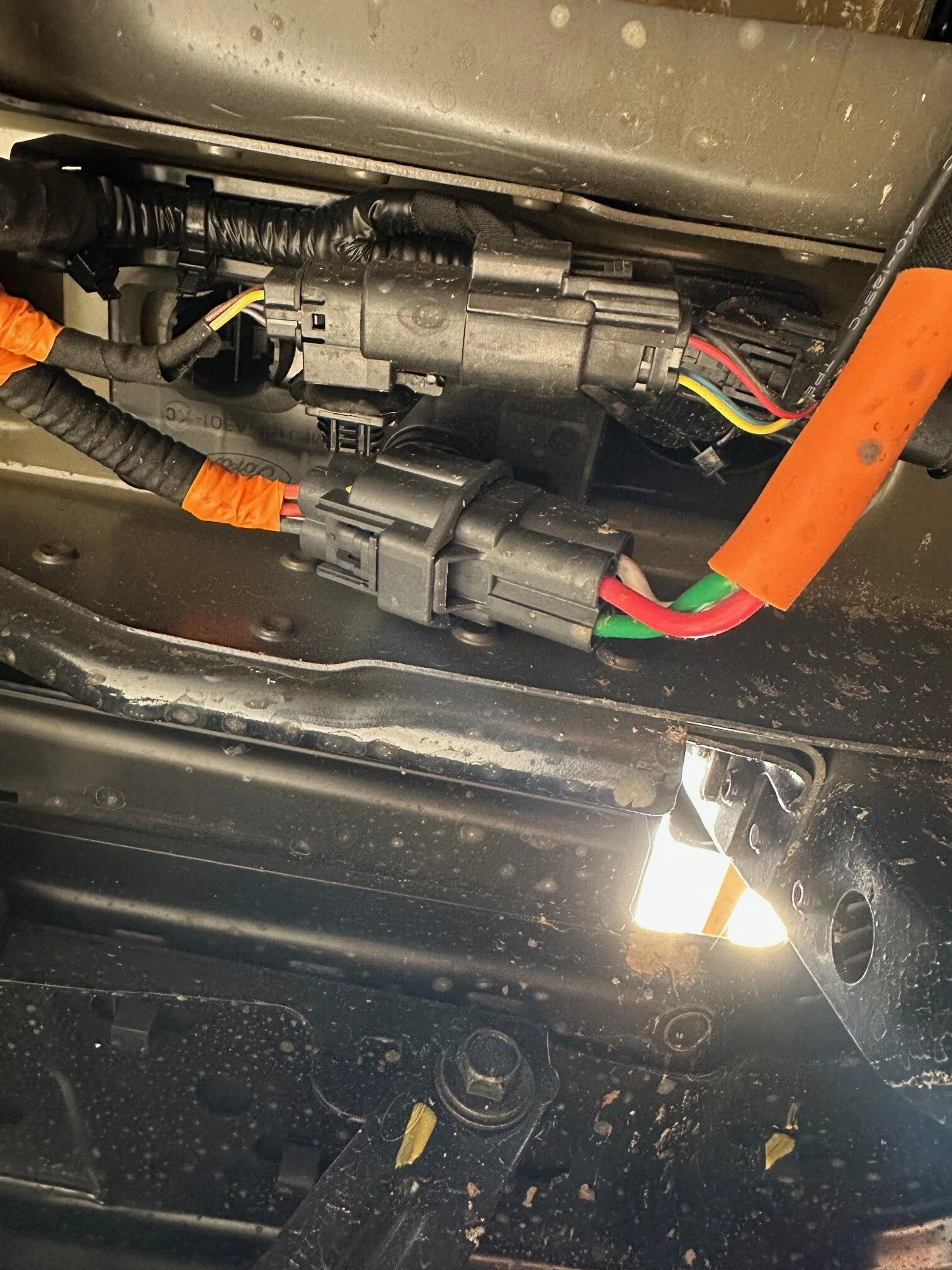

Hello, I just got my 2022 Platinum FX4 PB. Very excited about the 7.2kw generator. I intend to primarily use it to power our travel trailer when we boondock. I use both a bed liner and bed cover to keep the bed dry and secure and desire to route the cable out from under the bed to the trailer. I saw in another post here where a member routed his cable through the existing hole in the pillar down under the bed.(https://www.f150gen14.com/forum/thr...-a-trailer-while-driving-it-works.6462/page-3)

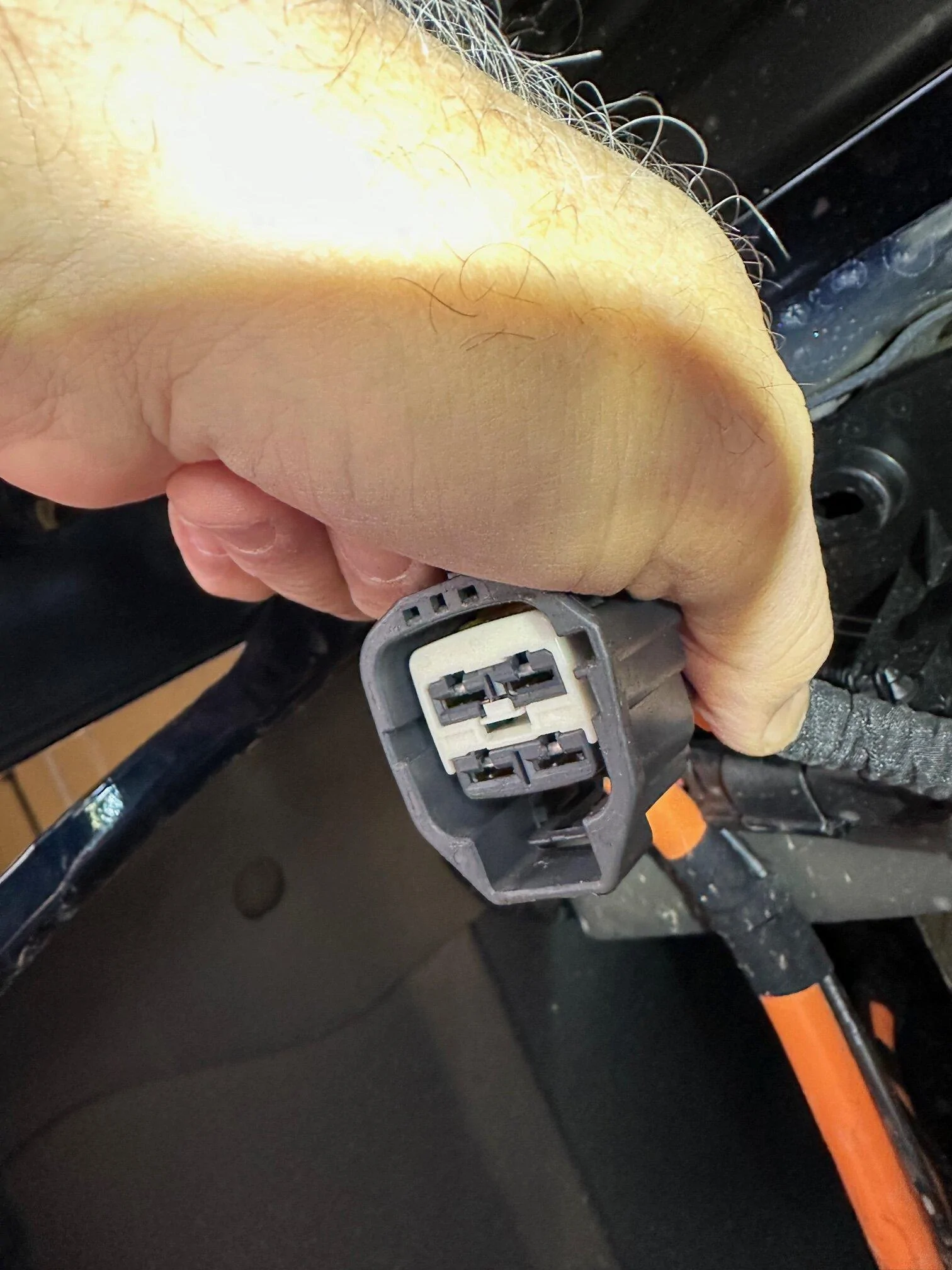

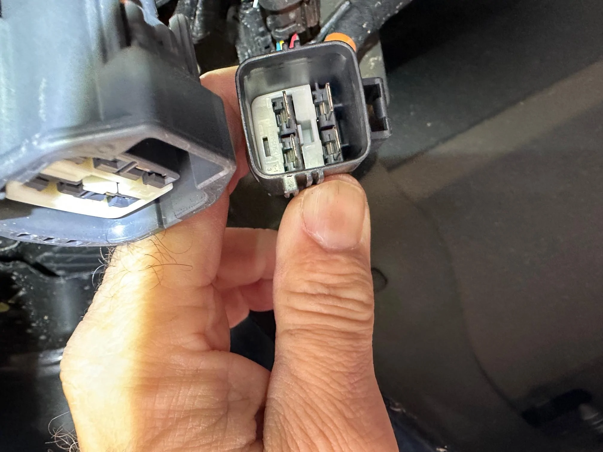

I was intending to do just this. However, I got under the truck this morning to investigate and found a connector I believe to be for the 240v. You can see from the pictures it is an orange cable with 4 wires. They appear to be about 10awg which would be right for 30amps. I looked all over the connector for ID information but found none. My idea is (assuming that indeed is the 240v cable) to build a Y cable using that connector and Y it out to a weatherproof L14-30R connector that would live under the bed.
Does anyone have any knowledge about this connector? Thanks in advance for any info.

When you disconnected it did it kill the outlets in the bed?
Have you put an AC voltmeter to the open connector?
That is the connector for the power to the bed panel. The other connector I believe is signal/control of the panel.
I learned it from removing the panel to install a bedrug.
Although that 240v connector looks decent in quality and seemed to be sealed, it is located in a harsh environment, in my opinion.
I applied dielectric and then encased it in a pool noodle to at least cut down on direct splash from road water/mud being slung at it.
It did, although I didn't measure voltage at the outlets. I did buzz the wires between that connector and the outlets. So, one clarification to my initial post is that the orange 4 wire cable takes power to all the outlets, not just the 240v outlet. However, that wouldn't negate my Y cable idea.
I didn't measure voltage at the connector, but I'm totally confident it would appear there.

OK, I might have just found the connectors. I found the Motorcraft Wiring Pigtails kits Identification Guide and perused it. I believe the 2 connector sides WPT-750 and WPT-1343 both available on Amazon for under $20 each. I also found a weatherproof L14-30R. If these are the correct parts, I should be able to obtain and make the Y cable.

Super late to this thread, but wanted to share my set up and lesson learned. DO NOT splice the connector! It is in fact feeding the power box above BUT the power box is set up a little different and if you splice at the connector your system will not correctly work! What I did, and it was actually pretty easy ----- disconnect both the power and control connector.....as seen above! The power box is held in by four screws .... then pull the box right out!
With the box out, there are six little hex screws holding the back plate ..... it comes off very easy! Once you have the back off you will now understand why! You will see how the power leads from the connector split and our distributed to the three outlets!
All I did was drill a 1/2 inch hole in the side of the power box and inserted a wet weather connector and used 10/4 SOOW to connect to the four screws on the 30amp/240volt outlet. I used 1/4 inch terminators and loop it through the screws and reinserted. Then I ran the wire down and mounted a 30/240 rv outlet on the rear bumper and connected! Works like a beast....and the on-dash power monitoring tracks the watts / out-put.
This is the safest and best way to go about it!
