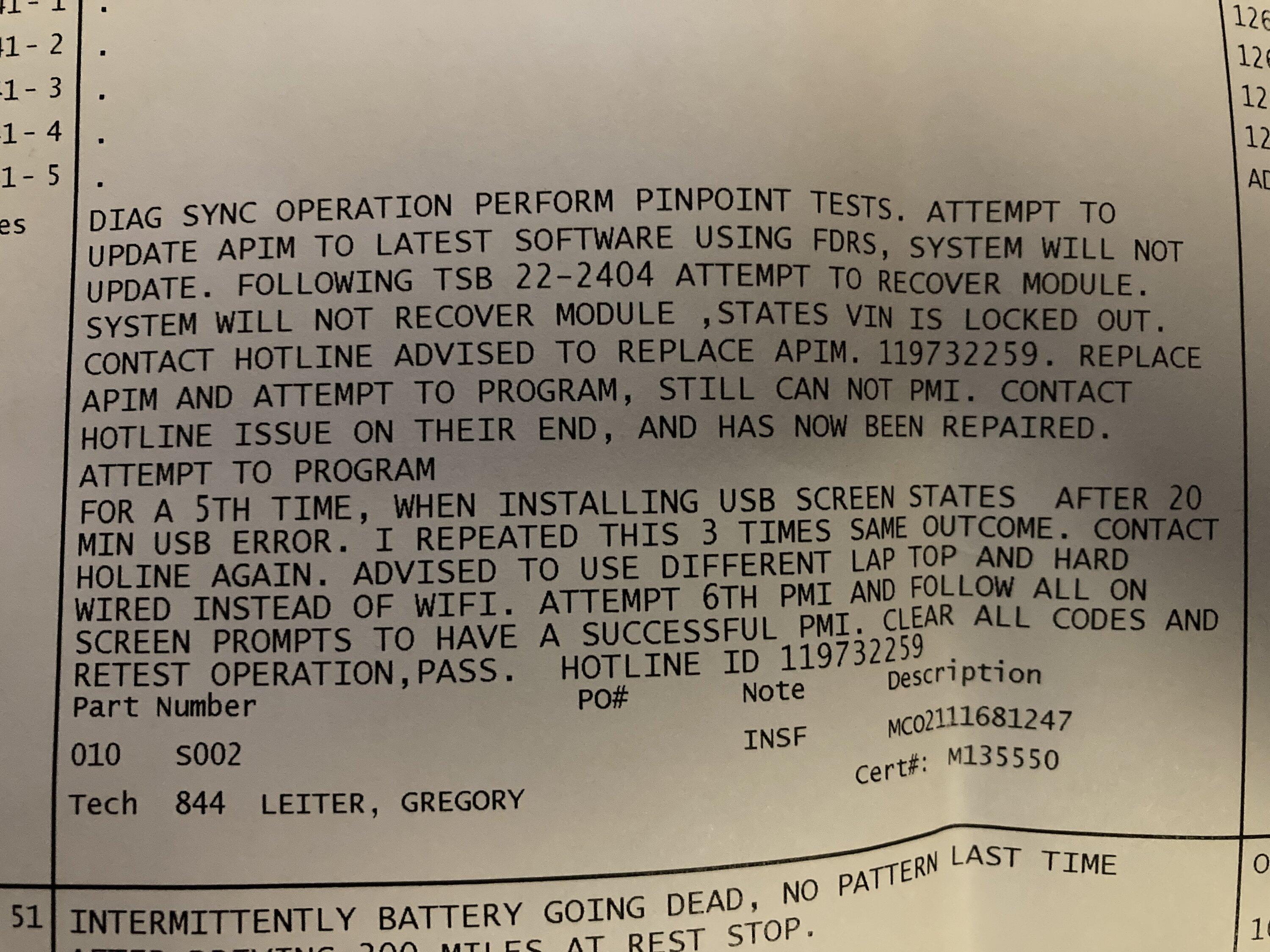

The following info may help someone in APIM hell, took my tech several tries but they finally got it after several emails to Ford. Biggest problem seems to be using wi-fi to run FDRS at the dealer, would cause USB errors. After the tech grabbed another laptop and connected using ethernet it took.
Thanks for sharing! Blue. The most interesting thing on that printout is the last line "intermittently battery going dead" this is the very first thing you're dealership should have addressed before attempting anything in FDRS. These trucks are notorious for having bad batteries and this is causing many problems with OTA and FDRS updates. I hope they resolved this for you as well.
The battery was replaced just before the APIM was ordered. This was a two month ordeal, a month to get the APIM and another month of weekly visits before it updated. Not sure what version I am on or if any OTA updates have happened since.
Yup, totally understand I left mine at the dealer in early spring of 22 after a month of nothing. I went and took it home un-repaired. I then bought a mongoose, battery charger and FDRS. 12 hours later the truck was fixed. Without the APIM they said was needed! And I've been getting updates ever since. Just 3.5.3 today!
