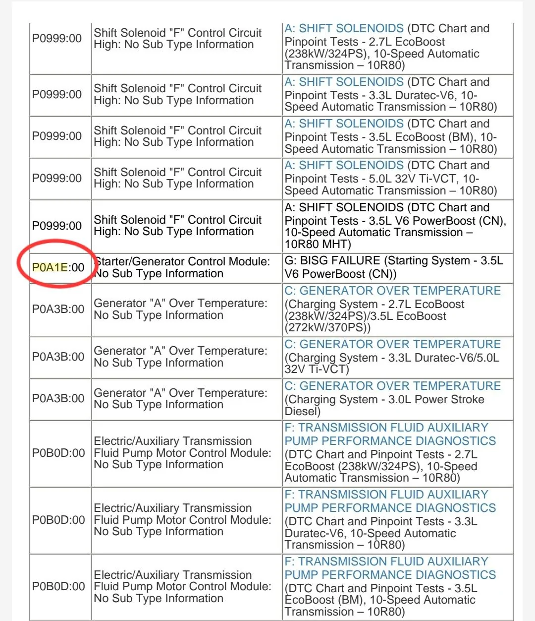

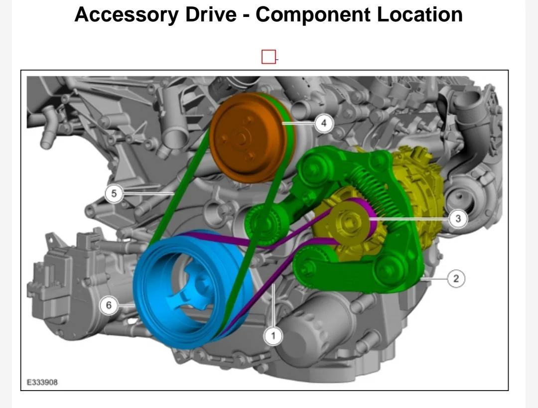

So my 23 Platinum Powerboost left me stranded about 10 miles from home. I stopped for a stop sign and continued on when the shifting seemed different and did not have much power, lots of faults, hi volt battery, sensors, wastegate turbo, Stop Safely Now, which I did. Towed to local dealer, they had for almost a month, they said it just needed the modules updated. Picked truck up this last Monday, drove for 3 miles and check engine light came on, went right back to dealer, they then said the starter and alternator need replaced. They called me Friday and said its fixed, so far all good.
