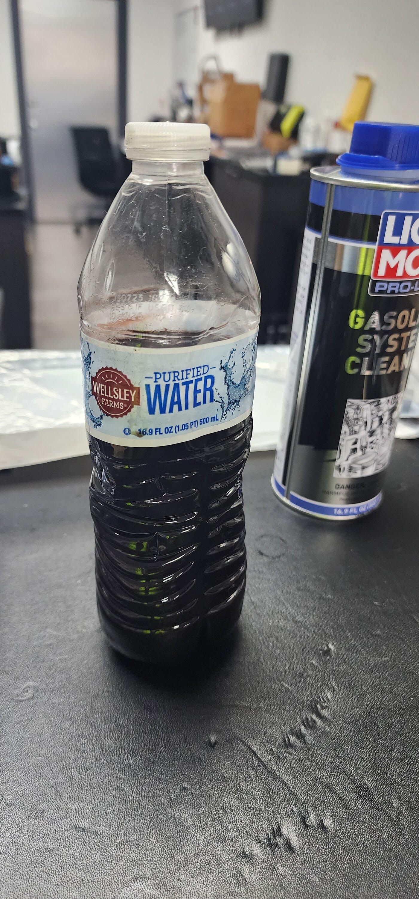

I had the transmission serviced after reading the threads on this forum. I had a local shop that only works on Fords and has been around 20 years - when I walked in and asked for it, he showed me a bottle he saved from another 10r80 at 40k miles that was black. He says he's done a handful this year on less than 50k mile 10r80s and they're all filthy. Here's what mine looked like.
I had hoped it would help, but it didn't really change affect the behavior.
Again, dealer was refusing to do the work (after reprogramming it) because of an exhaust modification. No tune was ever mentioned. The mechanic described it doing the same thing other 10r80s that are completely stock are in for - expeditions, mustangs. Can't believe people are keyboard warrioring for a major corporation trying to deny claims to faulty transmissions they knowingly produced and released.
I have no problem paying to rebuild my tranny if it comes to that, I just won't pay Ford or a dealer and I'll just go aftermarket on that too since Ford's OEM parts are less quality at this point. Anyone defending Ford or their dealers charging $70-$80k for a truck that has leaking transmission seals and then making it difficult for consumers to get it repaired, is why Ford and dealers do this kind of thing.
