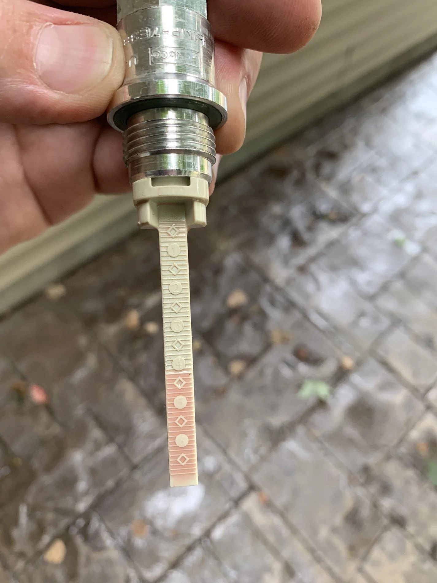

I don't think there's transmission dip stick to check fluid level. Truck needs to be on the lift and remove splash panel.
It's not a typical dipstick like we expect to see extended up and easy to access, but instead is on the side of the 10r80
...and to measure the fluid level the transmission has to be at operating temperature and the truck has to be sitting level. The dip stick location is right by the exhaust so you also risk burns while trying to get the stick out. I'd say it's not intended for the average Joe to check it in his garage.

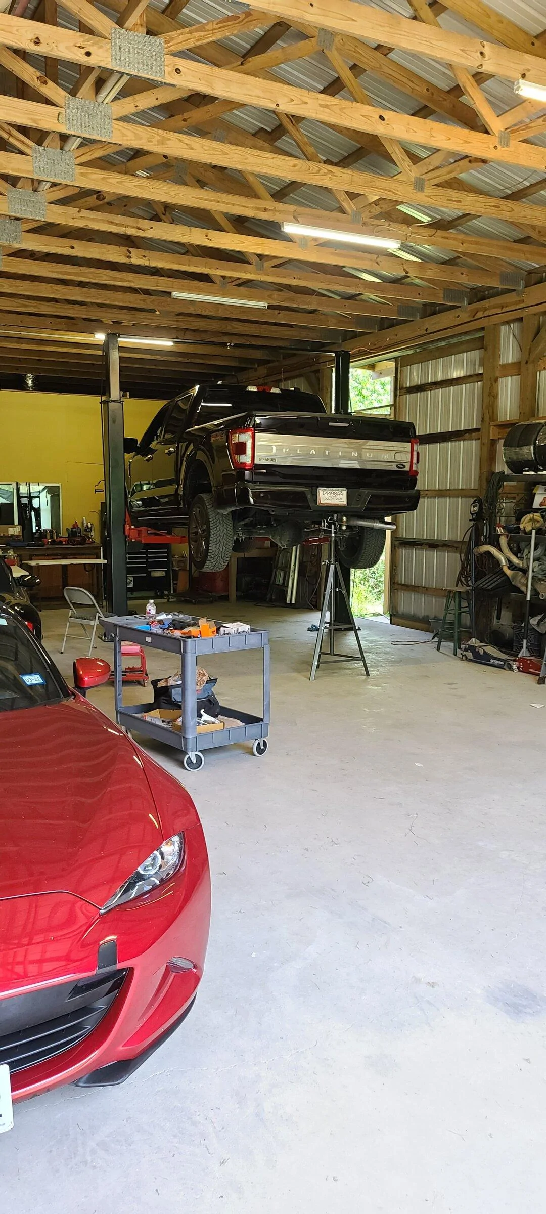

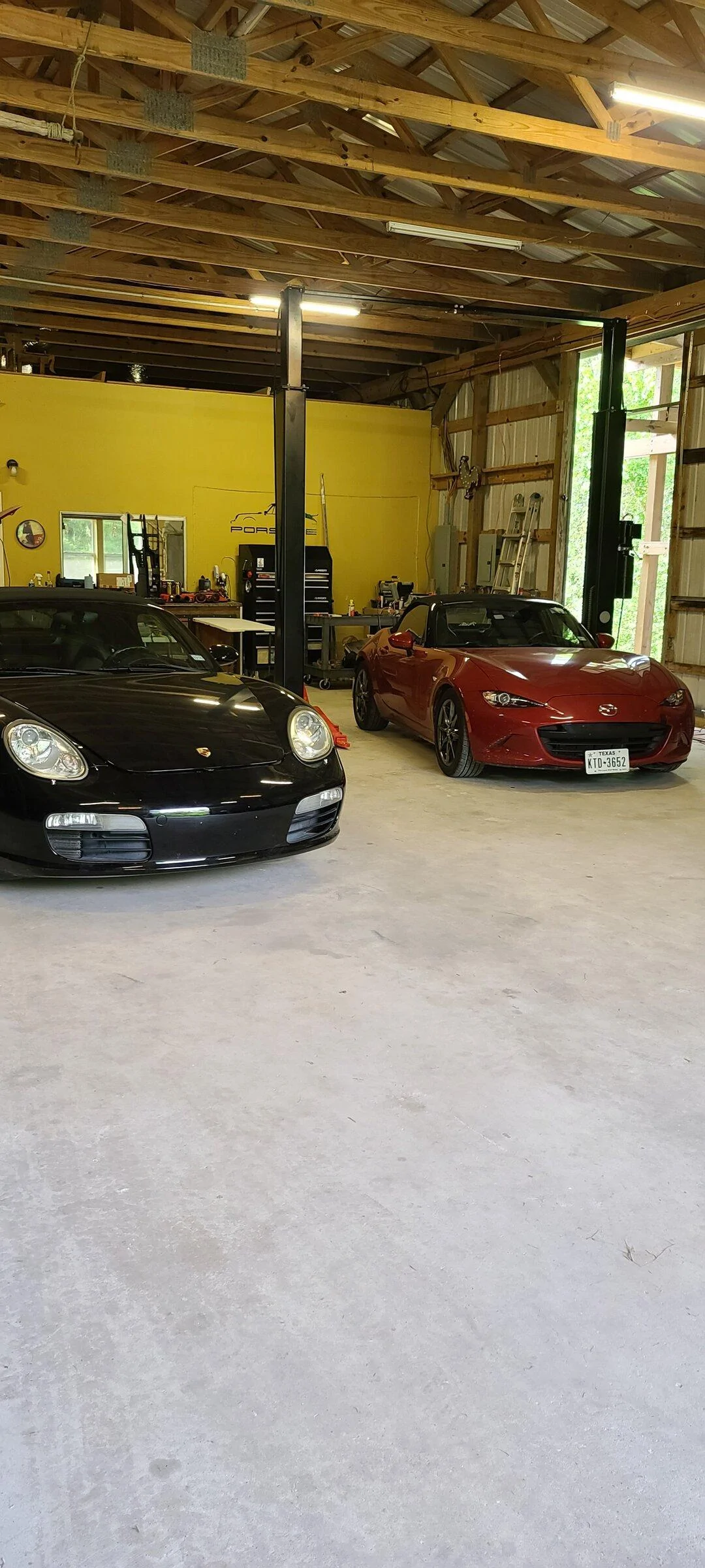

A little easier if
That’s quite a set up. What’s that in the foreground? Mazda? If so, does your Mongoose work with it?
I actually don't know, but possibly. I have a different ODB dongle for it though and have only used it for a 93 octane versatune. Not much impact, but crisper throttle response.
It was the previous generation Miata (NC) that was basically a 2.0 liter version of Ford's 2.5 liter.
But yea, the little Mazdarati is a blast.
