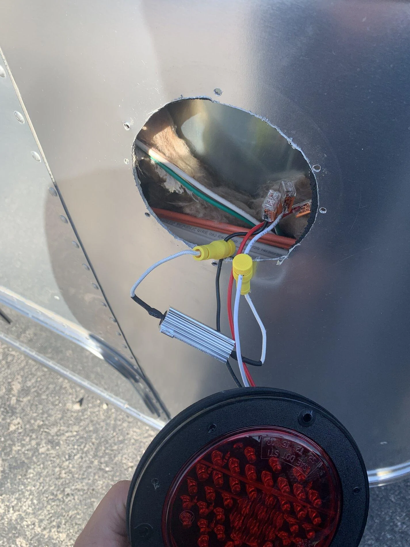

I added a resistor to the the airstream right tail lamp and no longer get the error. All fixed I guess.
BTW - At first didn’t work...thought it was odd no heat coming from resistor and was still getting error...used multimeter to confirm wiring and what do you know airstream used wrong wire. Once I connected to correct wire the resistor got hot and error went away.
Looks like you have an LED light on the trailer. There are posts on another thread talking about getting errors on the truck when the trailer has LED lights. Might be the same issue.
