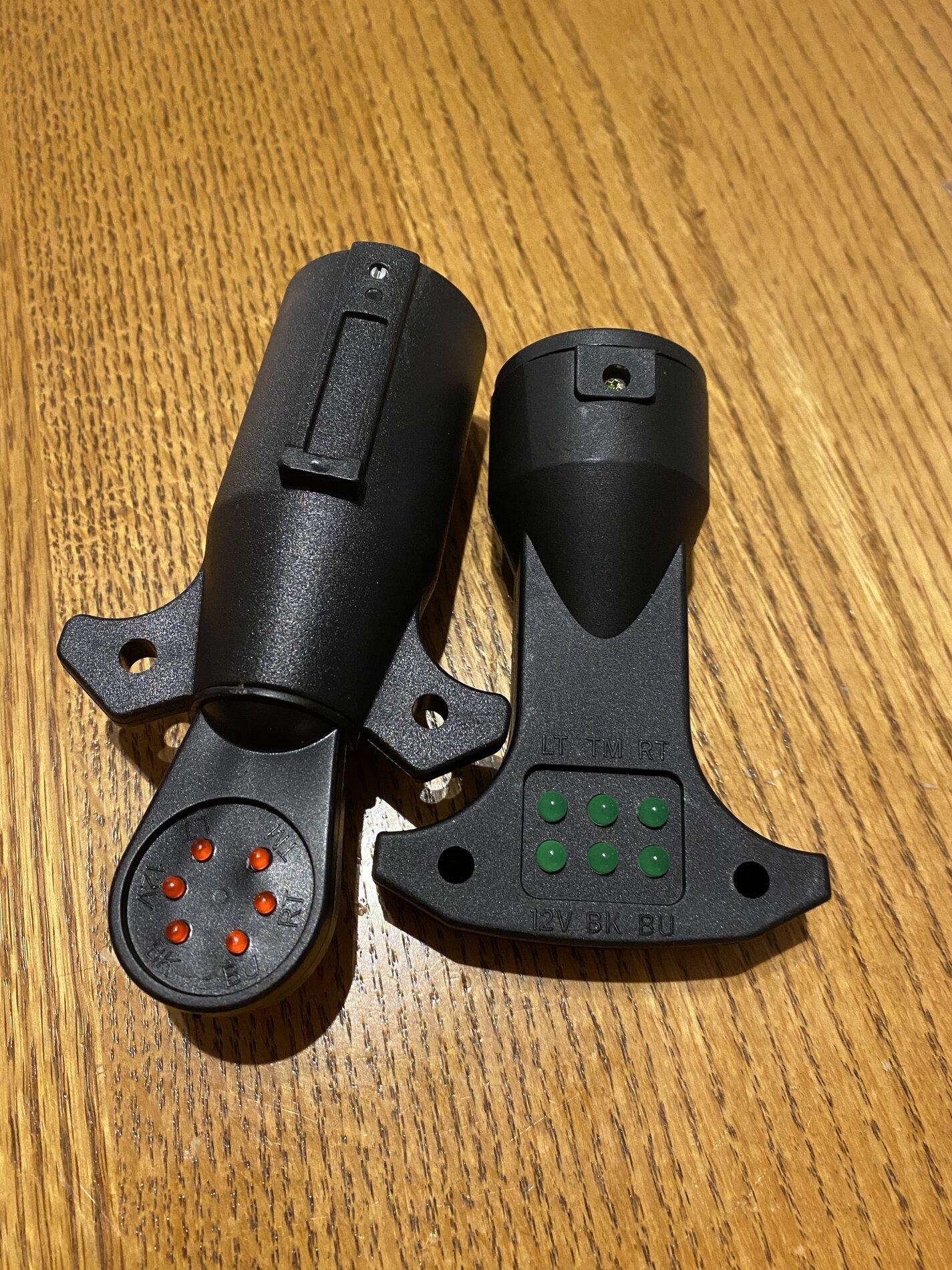

Ford F-150 Trailer brake not working 81F2DF7A-6231-4ACB-93DA-8159C0B025A4
Ford F-150 Trailer brake not working CA9A6916-01AE-4248-8F91-16446CC93011
I

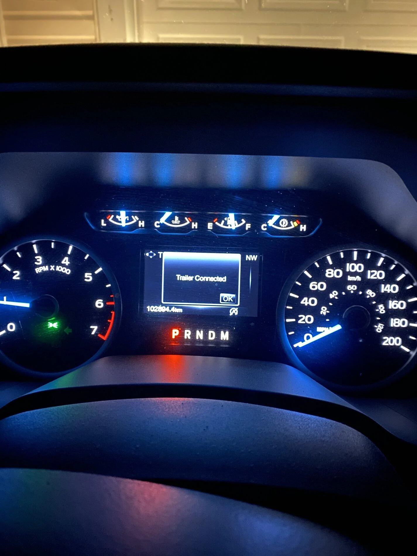

Ford F-150 Trailer brake not working 373CC464-61B3-4449-976C-05153B3F8ECF
I tried both of these testers on my 2018 F-150 and received the same results. Once the display ‘trailer connected’ appeared, I pressed in the brake and the truck showed ‘trailer disconnected.’ When I released the brake the display ‘trailer connected’ came back on. I also noticed when either units are plugged in, the brake light on both units would have a dim light flicker. I then went into my trailer settings and selected my trailer. I had the same results.
