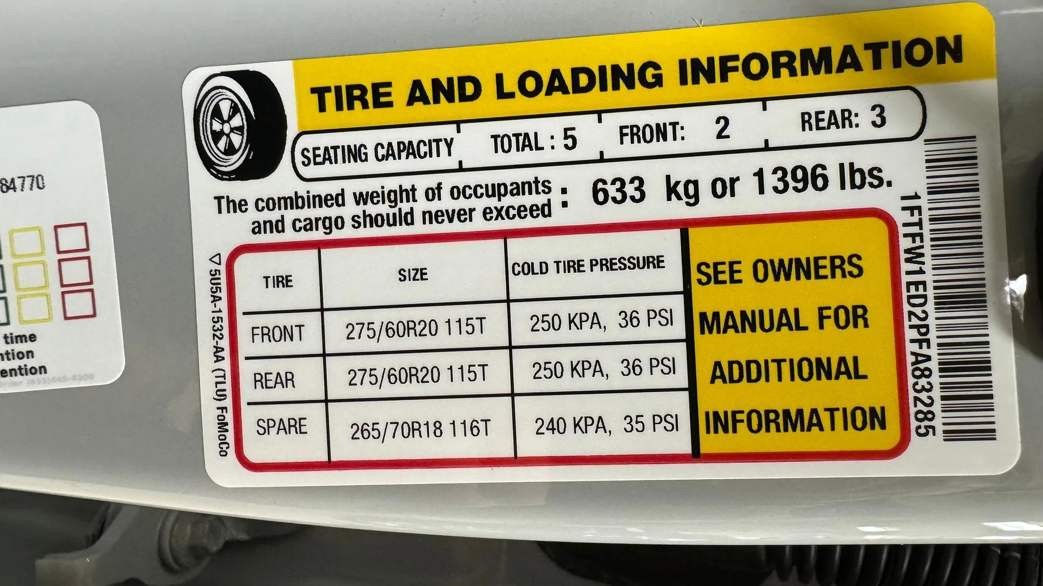

Let's see your payload sticker. You'll eat that up first which "should" limit how much you're towing due to tongue weight.
Ford F-150 Towing with my 2023 Lariat PowerBoost? IMG_3872
Ford F-150 Towing with my 2023 Lariat PowerBoost? IMG_3873

Rough estimates.
WD hitch 100lbs.
Random stuff in the truck 50lbs.
Passengers ___lbs
Any other stuff in the bed___lbs
Add that up and subtract it from your payload on the yellow sticker and that's your remaining payload.
Take 10-15% of your trailer gvwr for trailer tongue weight, not the trailer dry weight and see if you're over the remaining payload.

payload is your biggest problem. The Travel Trailer salespeople focus on towing capacit, not payload. I‘ve just retired my 21 Powerboost from towing my Lance 2375. Listed tongue weight was 800 lbs. in reality it is 1200 lbs.

With that payload, you'll have to be super careful about tongue weight and TT manufacturers are pretty notorious about understating them.
My actual, new, empty tongue weight, was around 300 lbs. heavier than published.

I have a 21 PB and everyone is correct you will have plenty of power. I tow a 29’ at 6359 lbs loaded. I have E rated tires, a Hensley hitch and never go over 67, enjoy the ride. I hit the CAt scales before each trip and just appreciate you are a heavy combo going down the road. Only downside to the E rated tires is the ride is definitely stiffer. The PB is a good choice.
