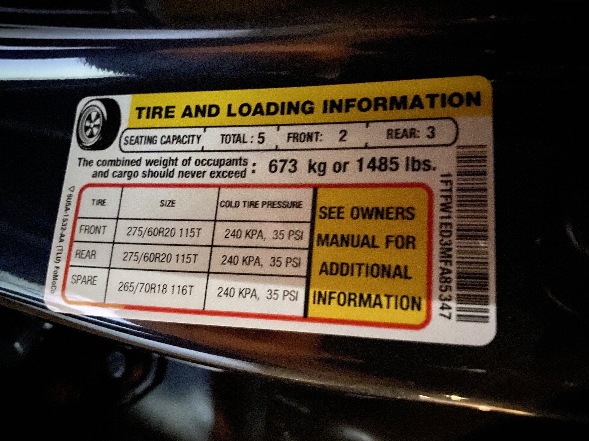

It’s not much, but 1485 here. I intentionally didn’t get the power tailgate package for this reason, it’s heavy. I also like the static running boards better, and this years power ones are incredibly loud so that was an easy decision to leave them off.
I have a sunroof and max tow.

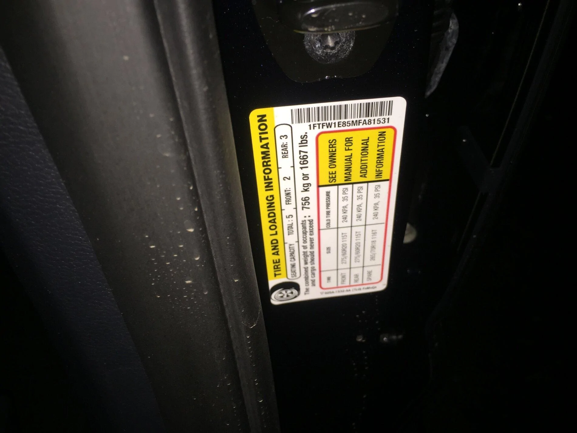

Here's mine - 1667#. 701A, 3.5EB, 3.31Std, 26gal, 4x4, Roof, Tow Tech, Work Surface.
Ford F-150 Towing Specs Consolidated Document - Bumper vs. Class IV vs. Tow vs. Max Tow - UPDATED DOC v4 Payload
is that a Powerboost? What Trim Level?
