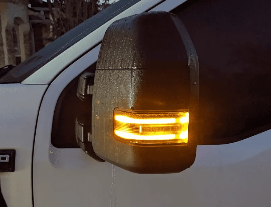

I did look at the Boosts before, but they don't any with cameras. So it was a no-go. I saw this out on the road today (someone else's truck). This is more like how I wish they looked. Here, the lights were actually steady on though. I can't figure out how to make mines do that.
On the oems the forward facing light is a running light while on the boost they are running and turn signal functionality.

Boost auto also sells just turn signal light lens separately to gain the functions you want. I just bought a set and they are awesome. Plug and play.

Do we know how to turn on those running lights? They look cool.
Since your truck didn't come with Tow mirrors I believe you need to add the running light modules to get the marker lights to work. More than likely easier to just retrofit the boost auto lenses. But I may be wrong. There are far smarter people here to correct me.
