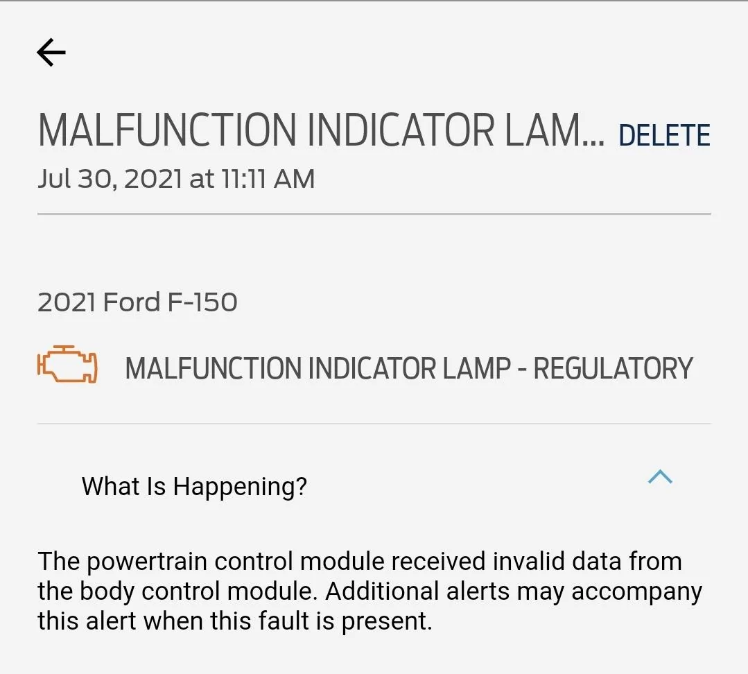

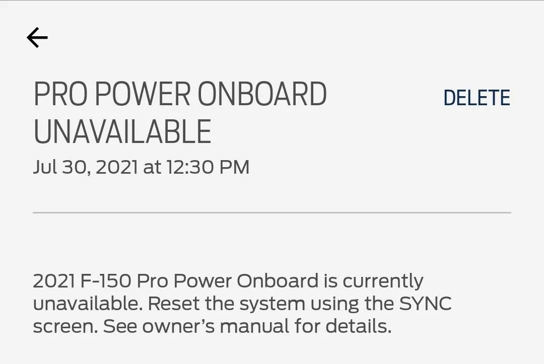

These are the messages fordpass gave me. Is this sounding like the phantom drain issue or am I just a lucky guy with a lemon.... :(

Ford F-150 Towed for major electrical issues Screenshot_20210801-041731_FordPass
Ford F-150 Towed for major electrical issues Screenshot_20210801-041629_FordPass
Ford F-150 Towed for major electrical issues Screenshot_20210801-041613_FordPass
Ford F-150 Towed for major electrical issues Screenshot_20210801-041439_FordPass
Ford F-150 Towed for major electrical issues Screenshot_20210801-041528_FordPass
Ford F-150 Towed for major electrical issues Screenshot_20210801-041547_FordPass
Ford F-150 Towed for major electrical issues Screenshot_20210801-041701_FordPass
