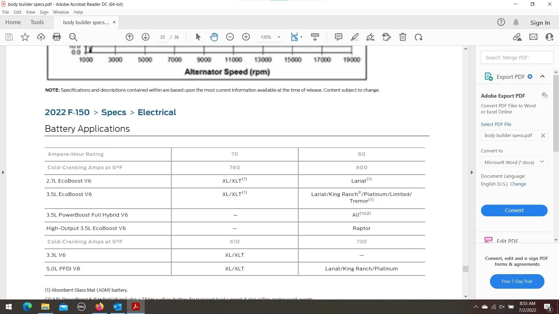

mine was just replaced becasue it failed because it failed to maintain state of charge and it was wrong size as specified in fords specification build sheets.
it was a 760 cca vice the 800cca.
i have had the new battery in just over a week and ZERO issue now with it loosing charge, even after opening and closing truck a whole lot doing the dash cam install,
in fact it dropped to 68% and while i was idling to log the camera in and set it up (20 mins or so) it recharged fully to 95% state of charge as indicated on battery charger i put on afterwards to make sure i had a full charge , sanity check.
the chart below specifies the correct size as per ford build on lariats and above
the ford rep on this site ..imo was very helpful in positive resolution. my dealer didnt blink about gettign it fixed right.
I just sent this to my service guy, I also have the 760 CCA in my Lariat...they are trying the "reprogram" thing saying the battery is good. Hope to get the truck back today. We'll see if the email even gets a response. Thanks for the info!
