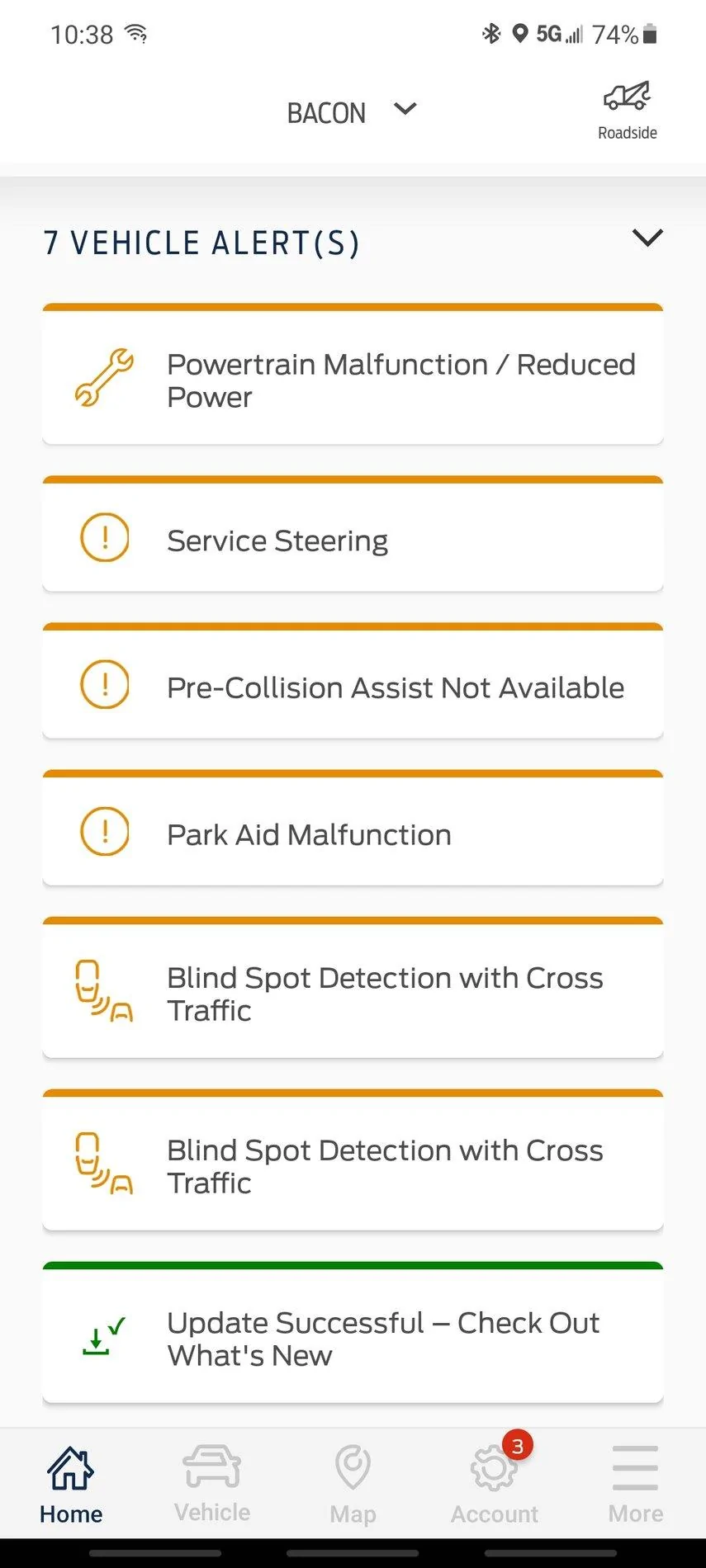

In early July i received an OTA update for my truck (STX 2.7L Crew Cab) and the next day i started receiving vehicle alerts about Blind Spot Detection and about a half dozen other things, i shut the truck off let it sit for 5 minutes and everything came back normal with no issues. Fast forward until today. I receive another OTA update last night drive the vehicle a few miles today and it starts ringing off the same vehicle alerts as last time plus even more. I feel my steering wheel getting harder to move so i pull over and shut the car off, let it sit for 5 minutes and this time it would not turn back on. Had to get it towed to the dealer, which was a pain because i couldn't put the truck in neutral until googling and figuring out how to manually force it into neutral. So here i am sitting here writing this with a Camry in my driveway instead of a the expensive truck i purchased. This is my first ford and has me 2nd guessing if i made the right decision.

*Update* Day 26 of the dealer having my truck. Its finally fixed. It was a faulty gateway module that was not allowing the truck to shift in gear. According to them they part was backordered from Ford until the 19th of August.

update #2... 5 days after having the truck back i get the same issue. Truck will not start and will not shift into gear. I got it towed back to the dealer, and i started a buy back case with ford. Im all done!!!!
