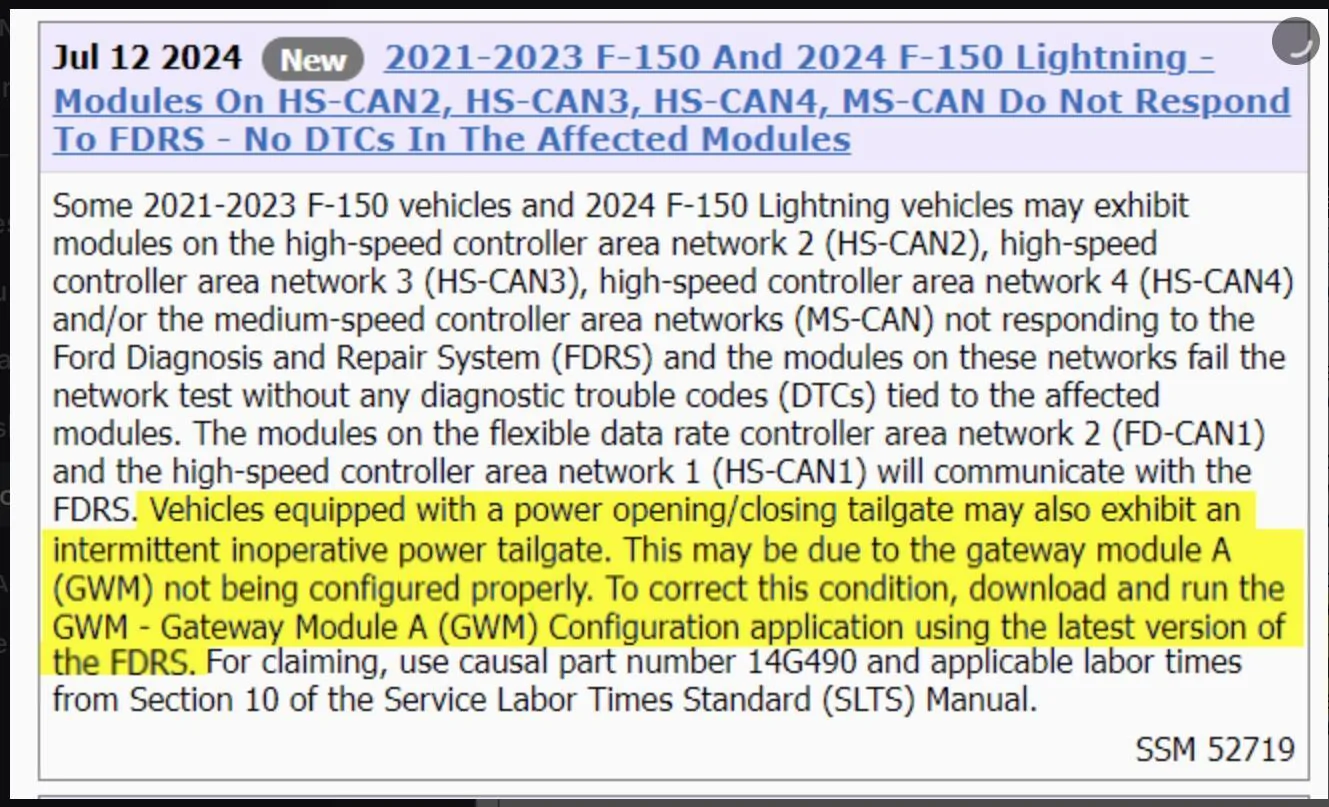

THERE IS A NOTICE ABOUT THIS ISSUE.
Ford F-150 Tailgate button not working. 1721589131893-a4
