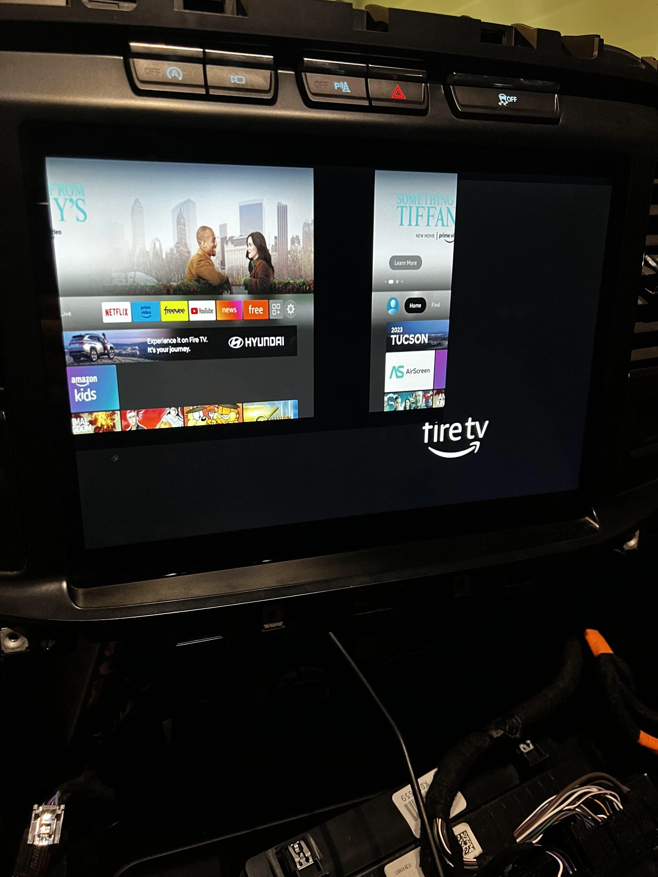

This is what my screen looks like when plugging in fire stick 4k. I just am not having the best of luck here lol. Sucks too, worked flawlessly with hdmi adaptor for months. Returned and ordered the base model fire stick in hopes that solves the display issue. And yes, this fire stick worked fine and display was perfect when tested on a tv inside the house.

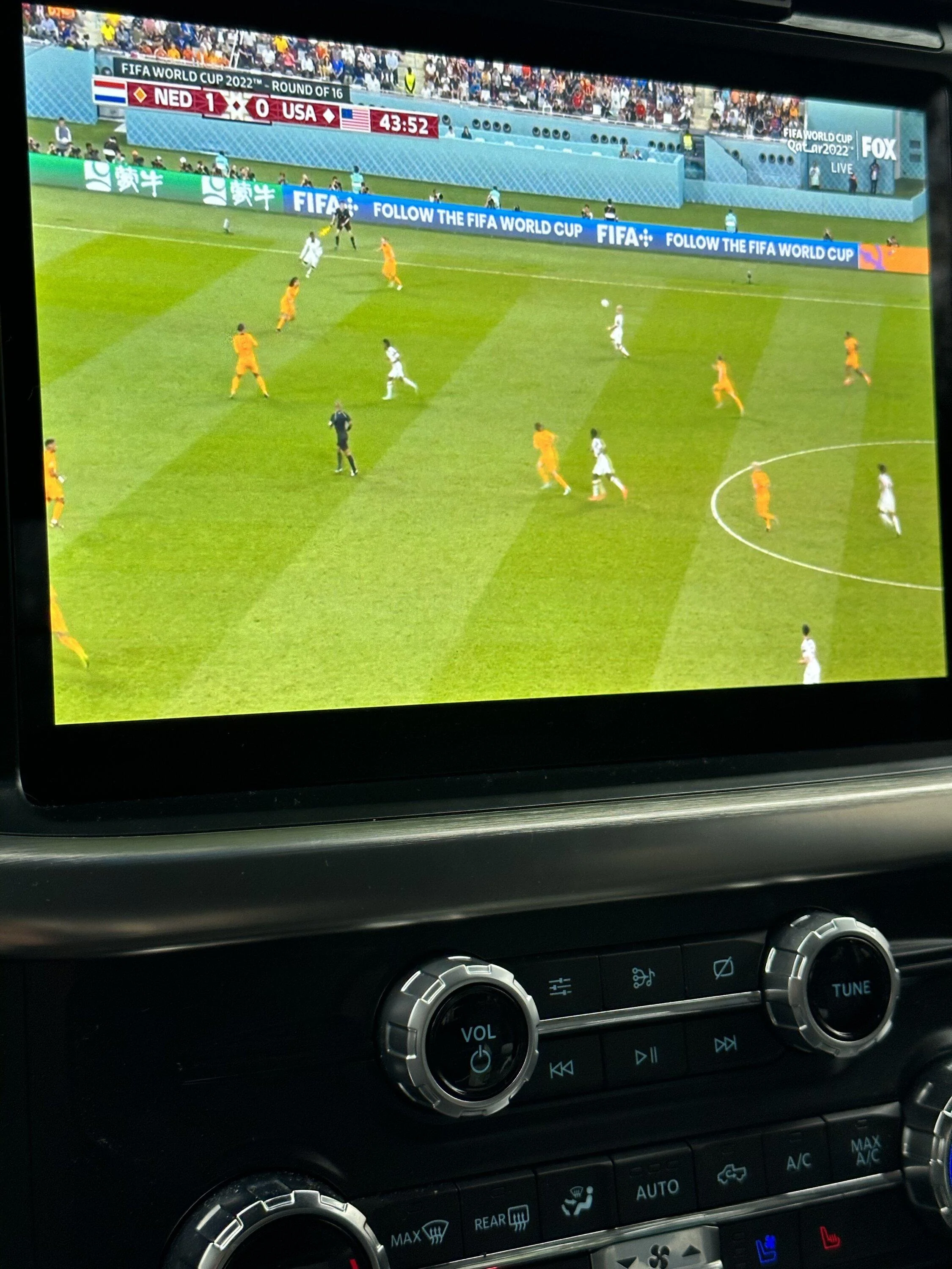

mine has been working flawlessly

Nice! Hdmi adaptor or fire stick? What fire stick model?
fire stick 4k (not max). I used an hdmi cable with a female to female coupler on the end

interesting. I had the 4k as well. Not max. Plugged right into the unit
I thought about plugging it straight in but wanted the option to change to a Roku or Chromecast without pulling my truck apart. I also connect my laptop and use it as a second screen when I am working in my truck and connect my phone from time to time so this gives me the most flexibility.

Update: well I got the gen 3 fire stick and plugged into naviks unit. It worked right away. Thought that was that. Put all my trim pieces back on, etc. went to start it back up try it out and the display was messed up again, same thing as the picture I sent above.
mad that I had to undue all plastic trim again, but I got back to it… I unplugged everything from the naviks unit a couple of times and finally it worked, normal full screen. (I also did this with the 4k fire stick I had, but at the time I thought since it’s still not working, I will get the original 1080p gen3 edition that must be the issue - this screen can’t handle 4k. Don’t think that’s the case as the 4k edition can run different display resolutions i Learned, and another users 4k edition works fine )
so now I’m Hesitant to button all the trim pieces back on again. I’m not sure if my unit is faulty somehow?? From all the hdmi adopter problems, now this fire stick. ?? It’s gotta be the hdmi plug in I’m guessing?? Talk about frustrating. Is very sweet when it works! Not sure what the deal is.
End of the rant - I got it working as should and I temporarily just popped the bottom trim piece in. Back inside for the night. Will test out in morning to see if it’s still full screen and normal
As a side note I do have aftermarket system in my truck since day 1. A 10” sub hooked to a 5 channel amp hooked to a pre amp expensive module that retains and integrates into the factory screen. Not sure if any of this can be causing a problem. Doubtful as it’s seeming a buggy, flickering, not stable hdmi connection
