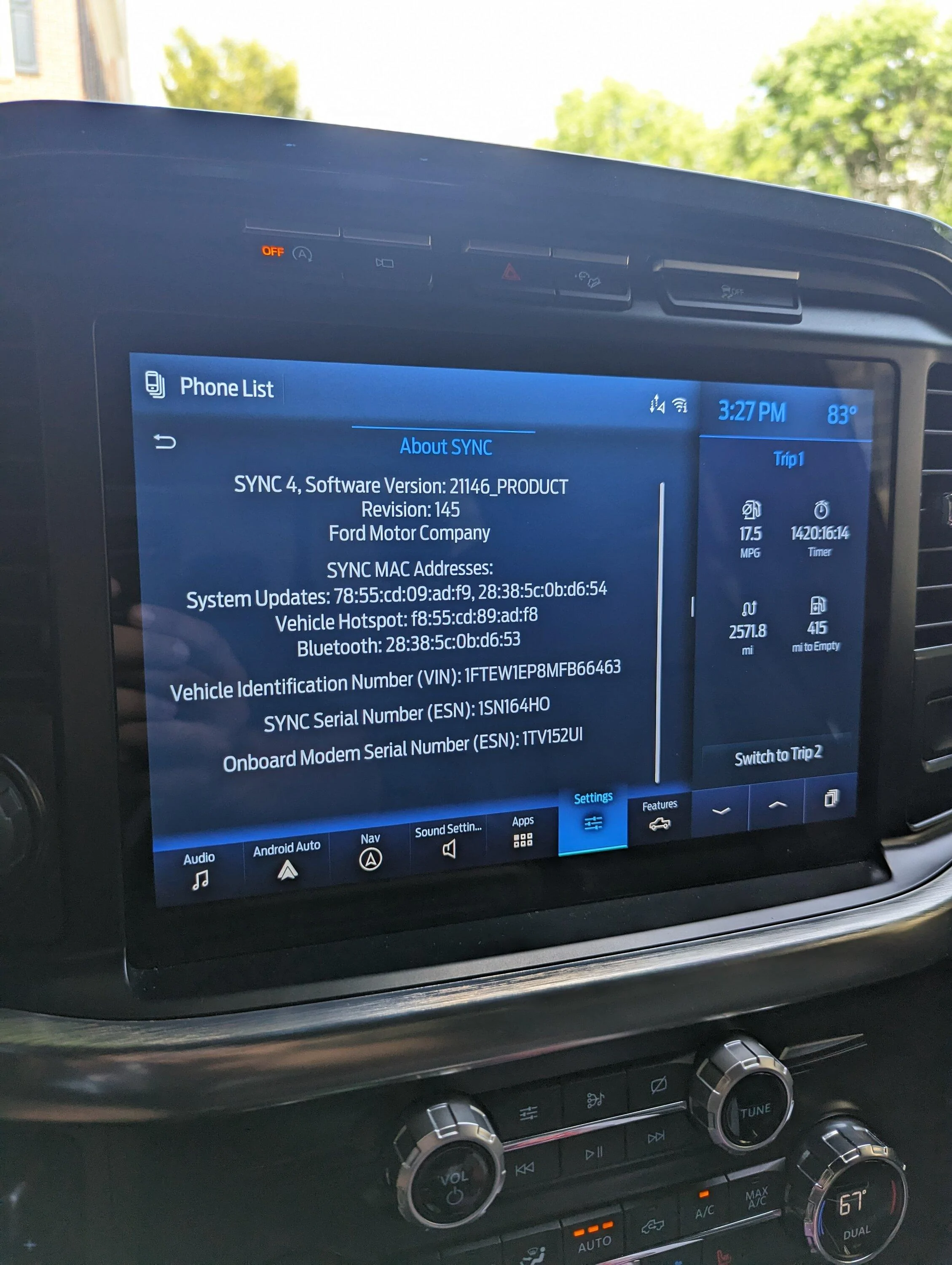

I was able to take it to dealer and have them update. Latest ABOUT SYNC screen is below. How would I go about it this is the latest or not? Something I don't see is the ability to do full screen still.

No where near up to date, but they did get your truck out of OTA purgatory, so you will eventually start getting updates whenever it is your truck's turn to get one. It will be a looooong time before you are fully up to date with the OTA process.
Edit: They performed one APIM update and one GWM update.
Thank you so much!
I think it might be worth forking the money to do this via FDRS.
