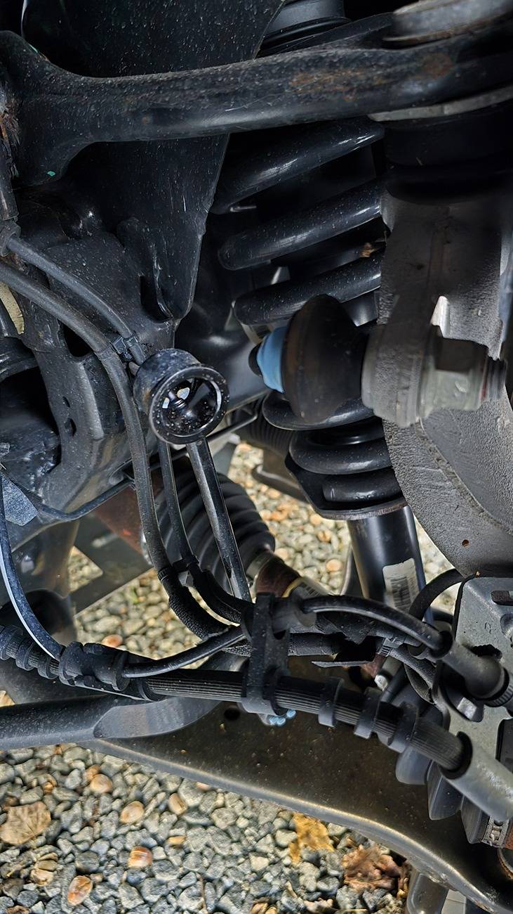

Ford F-150 Sway Bar Stabilizer Links IMG_5449

The $50 and 5 minutes it takes to replace it are more valuable to me than leaving it at the dealership for a day.
So do I go with the Motorcraft and change only the side that’s clunking? Or go with the premium ones on each side?

It’s your call
Personally, I would change both with the Motorcraft links

Dont use factory, theyre trash. I used moogs which might be trash to but at least they were cheaper than OEM Ford. I replaced both. My truck has 6k miles on it and found a broken end link this week. Theyre literally held together with riveted plastic. Mines under warranty to but it was easiar to spend $60 and replace both real quick than deal with trips to the dealer and waiting for them to do a 5 minute per side job.
How does that happen? I’m pretty sure I killed mine with an impact wrench. I didn’t know you’re not supposed to do that until after it was too late.
