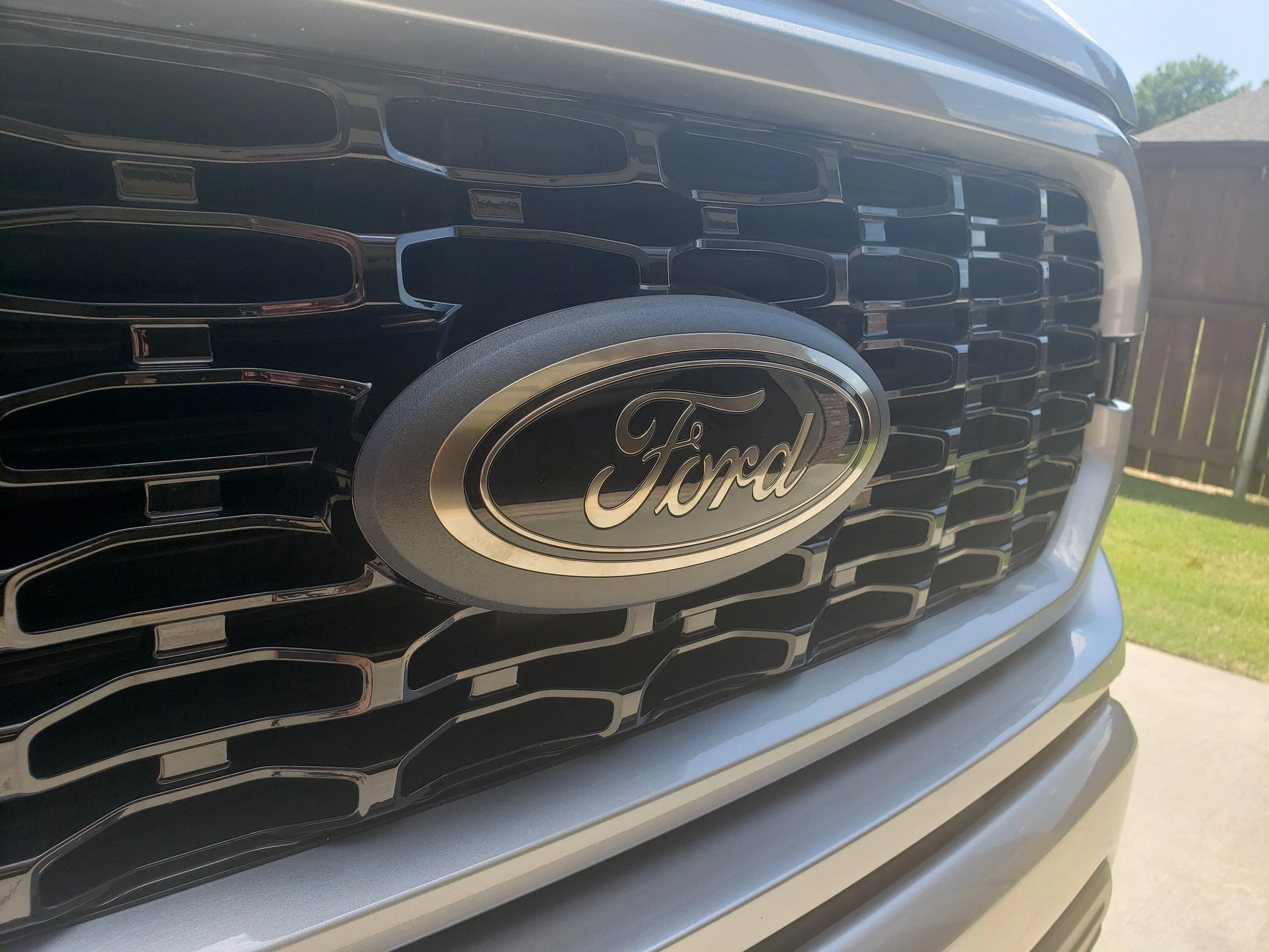

Most emblems will, but make sure you have front camera or not, I went from Ford blue to smoked and black.

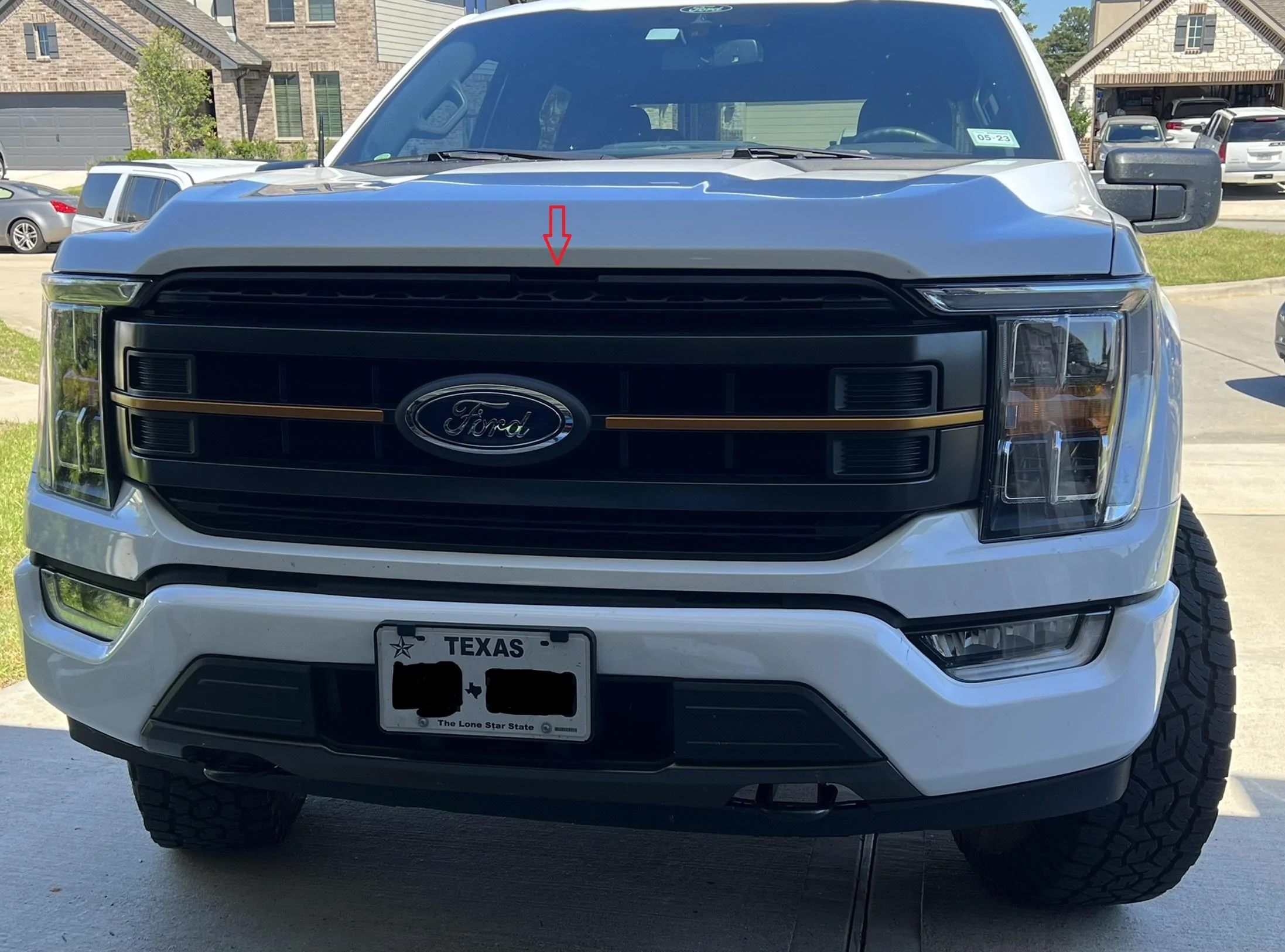

Just swapped my XLT Grill for the Tremor Grill. Kept the blue Ford Emblem because truck doesn’t have the 360 view.

Thanks! Looks great

Was it a straight swap, I thought tremors had different hoods?
Straight Swap. I took a risk on seeing if it would fit and it did. My understanding is the tremor hood sits over the top of tremor grill.

Like it!!

Looks good. Like you said it is a straight swap. The only issue is that the Tremor and the BAP hoods cover the top of the grille so the hood latch cutout isn't visible.

Gives it better aero dynamics lol! That doesn’t phase me at all.
