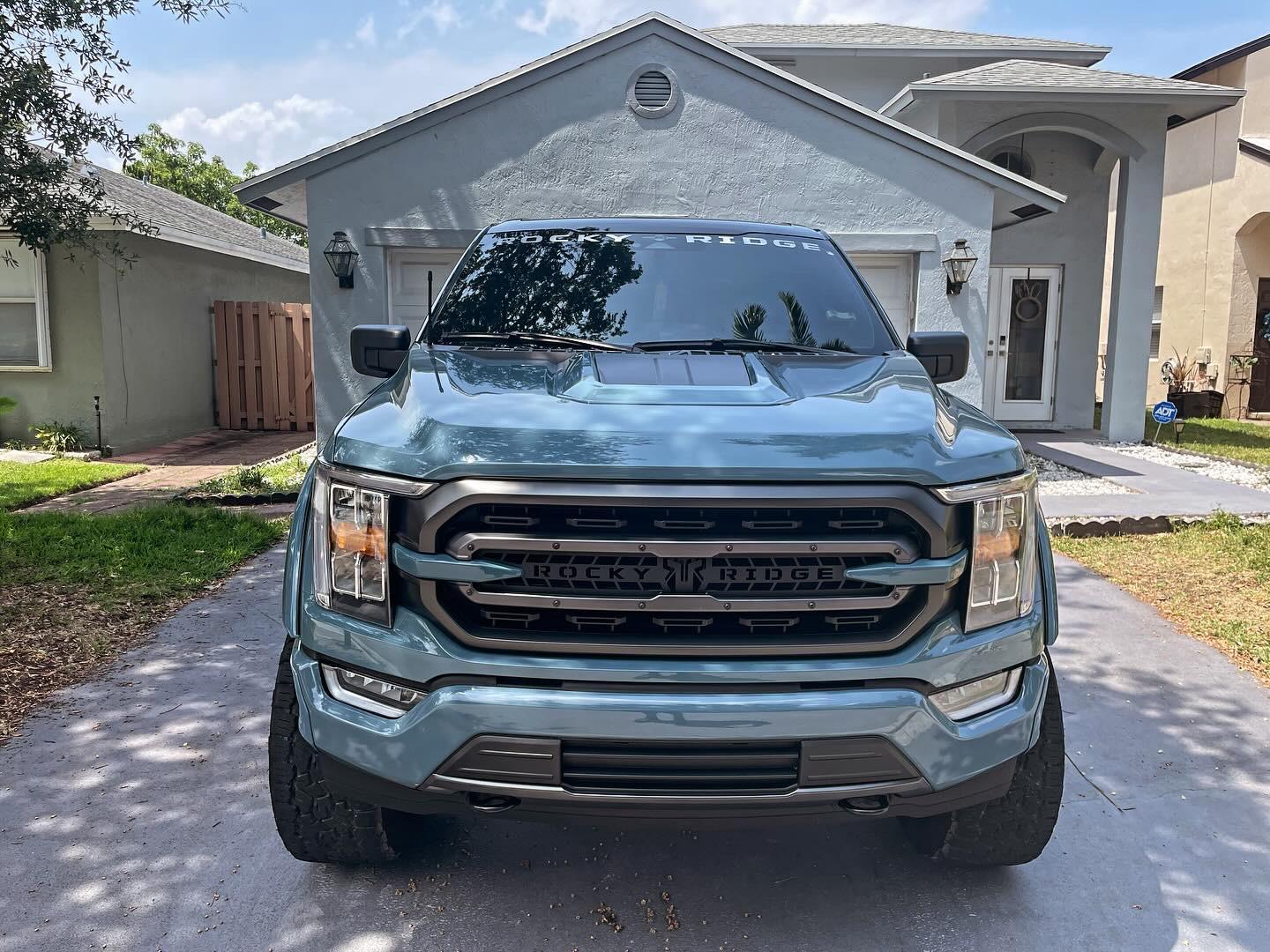

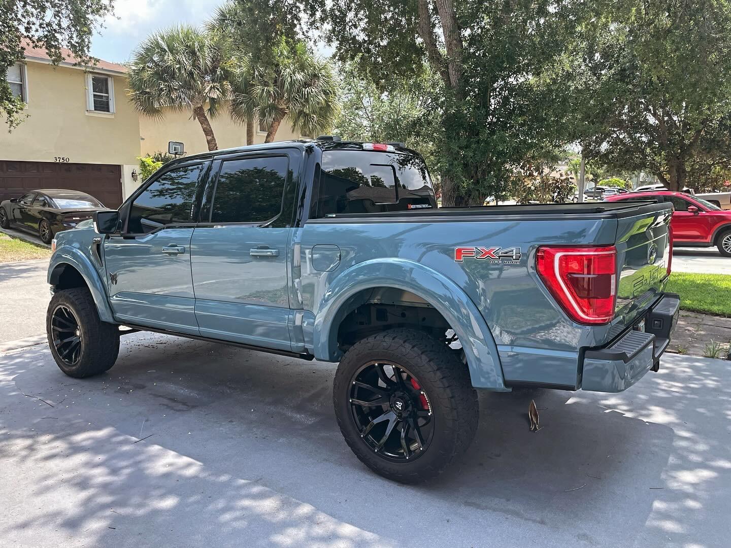

I myself just added Tow mirrors to my 2023 Rocky Ridge F-150 and went with Boost Auto. I love them and they’re great looking! Definitely resembles the factory OEM style Tow mirrors. And if you go onto their website, they give you tons of options and it’s a simple plug and play so there’s tons on DIY YouTube videos for every brand truck. I hope this was helpful.
