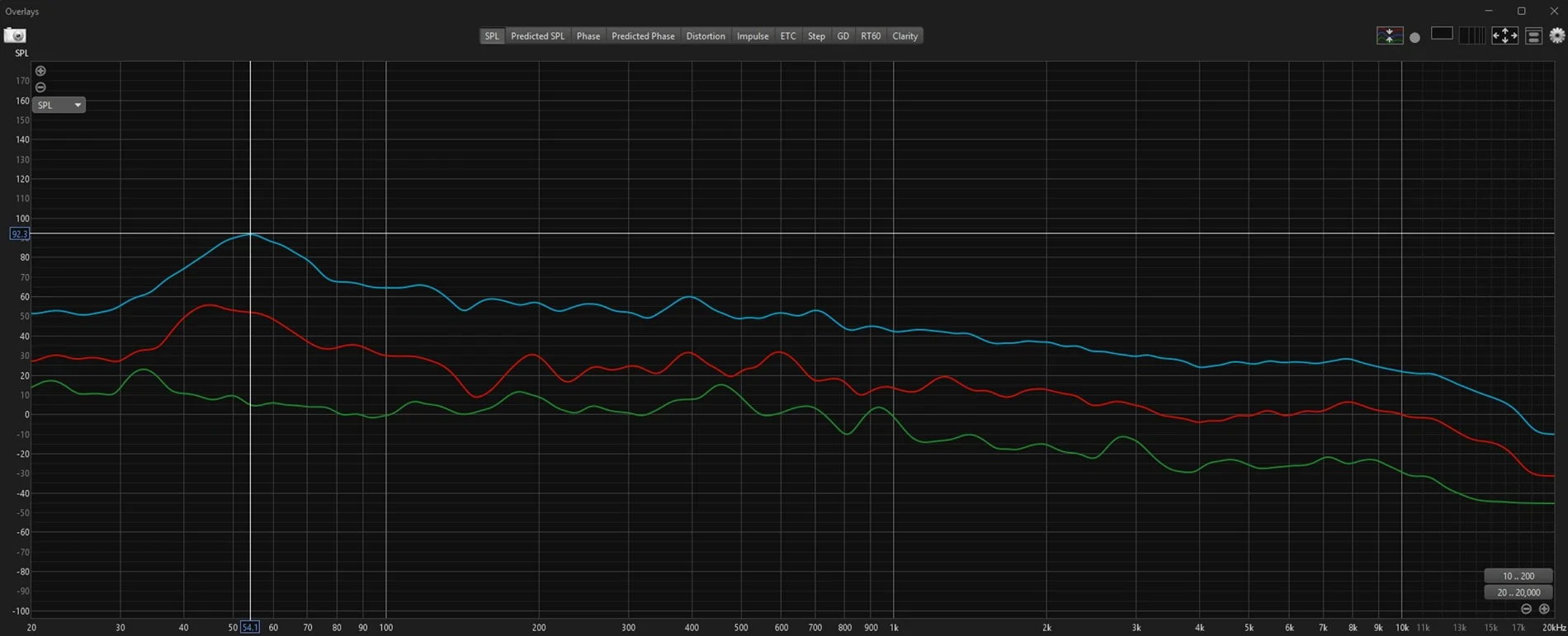

I purchased a 2025 with the B&O Unleashed, as I was trying my hardest not to do another system. I know lots of people don't like it but for what I'm looking to get out of it, it works for the most part (100x better then the Bose system I had in the Silverado). I knew I'd eventually do something with the sub and I ordered a SGS Stealth v2 enclosure and I paired it up with a JL VX1000 I had from my last truck. After I got the enclosure installed, I put the RTA on it and I was surprised at how the OEM curve looked for mids and highs. The green line is no EQ'ing and the SGS @ about 30% output on the JL remote knob. The red is with EQ set and about 40%. The blue is with EQ and about 50% output. The only part of that curve I have control over is from about 100Hz down so the rest of that curve is factory set.

That looks like a pretty well tuned factory system there. Looks like you used REW RTA to measurre that. Did you use a UMIK-1 microphone in a figure 8 pattern around your head while seated? I have the itch to do my truck again. I have AutoFrog GB10, GB25, GB60, and GB12 drivers just sitting in the attic and a JL VXI 800/8i.

Yes, that shot is REW. I did it after using JL TuN and using it's measuring function. When I tuned my last truck, TuN didn't have a measure function. I've used REW for a while and wanted to make sure it matched up with the TuN software. I used a Behringer ECM 8000 with a MXL Mic Mate preamp. Since the only thing I could tune is 100Hz and below I did multiple runs from the center of the driver's seat.

Amazing response... gotta love REW (of course I wouldn't be biased in any way).
It's amazing what sound deadening and the tiles combined can do with the block off plates to help better seal the doors. For every day listening... perfect. Obviously, if I were competing, I'd replace everything, but I ain't and won't be. I do believe adding a JL Stealth box or similar with a good amp is worth it... just makes the entire system sound better.
