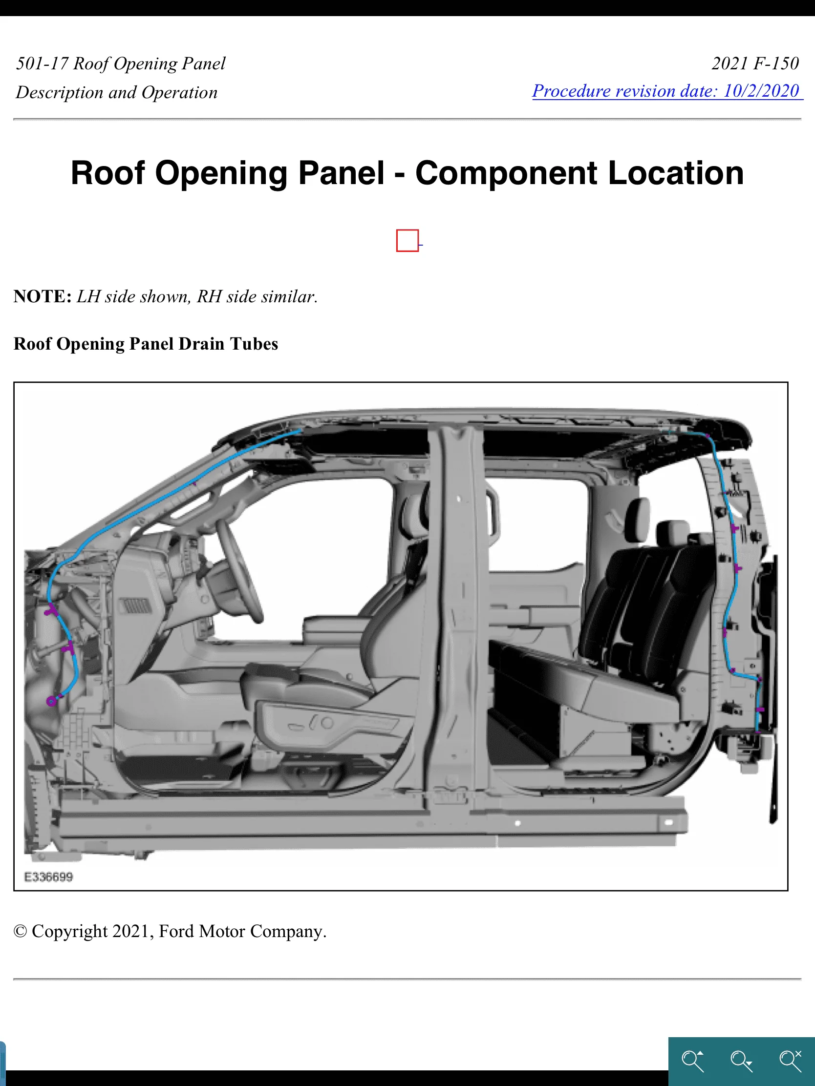

There are drains at the front and rear of the moonroof channels on both sides that exit at the bottom of the A and C pillars. They need to be kept clear. You can use compressed air.

Had them before without issue, but i never used them, so, i ordered without to eliminate that possibility and save money to boot. Way to many that have waterleaks and that shouldn't be happening in the first place. Maybe ford should use larger drain hoses to allow debits to go through easier. In any case, if you decide to blow air in them, be careful and dont use to much pressure and blow the hose off the nipple it's likely attached to, unless they're possibly clamped on

A piece of grass trimmer line works well for clearing them.
