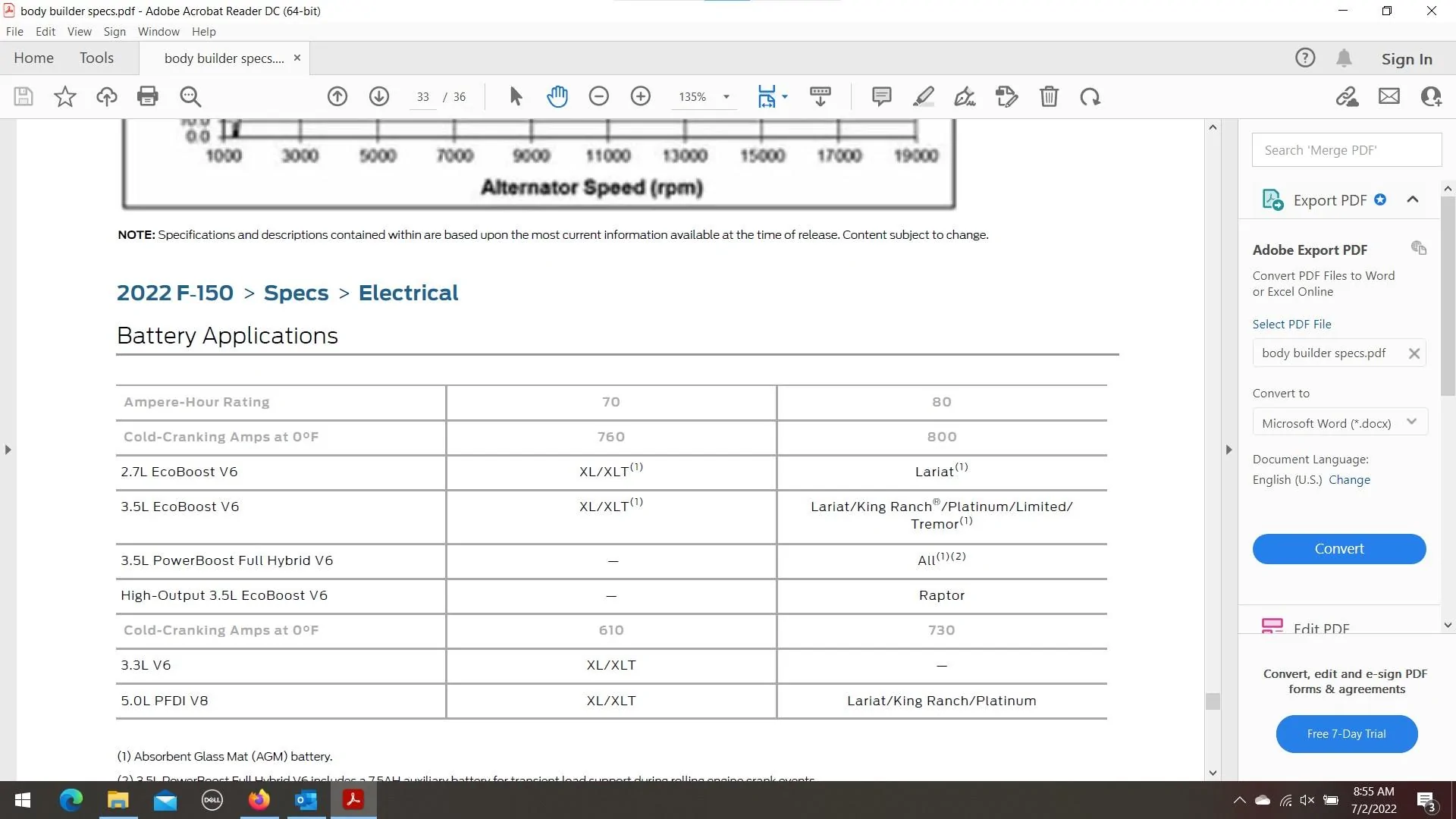

but the take away for me is the wrong battery was installed at the factory and did not comply with the 2022 specifications.

I have been scouring the web and this forum trying to find what was a similar screen shot somebody had showing the Lariat build battery specs, which show it having the 800 CCA battery standard on all Lariats for 2021. I can't find it, and I looked thru the Manual, and the service manual as well.
If I can ask for your help, where (or what document) did you get this screenshot from Robert?
I was talking about my battery low voltage issues to the Service writer at my dealership. I want to attempt to save the pic for him to help pressure dealer to get the proper battery for my model. Feels like the least they could do...
it came from ford body builder web site that lists ALL specifications for Fords
this from the f150 section
its usually hidden in the commercial vehicles section of ford
but search for body builder
https://fordbbas.com/publications
then tab down to more vehicles etc
Thank you very much. Way better than going in with "I saw this thing, somewhere, but I don't remember where..." lol
Try this website. eSourceBook. I think page 26 is what you're looking for.
https://www.f150gen14.com/forum/attachments/2021-f-150-source-book-pdf.831/?force-system-browser=1
