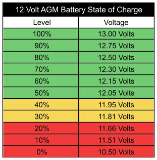

This chart is not 100% accurate as all battery manufactures voltage will vary a little. But not much of a voltage change will bring the state of charge down.
