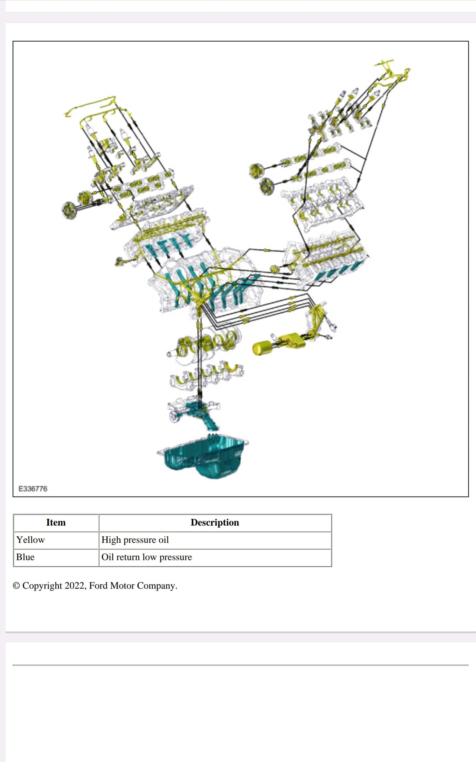

Big Dog Daddy
May 27, 2021
2,453
3,934
New Jersey
The auto start/stop equiped ICE trucks have extra lines to keep oil where it needs to be for constant restarts.
I'm not sure what you are trying to say here. The 5.0 Coyote's oil pump is directly driven by the crankshaft, when the crankshaft stops turning during an auto start stop event the oil pressure drops to 0 until the restart commences. What extra lines would maintain oil pressure during a start stop event in an ICE engine?
Ford F-150 Starting Engine from a Stop Screenshot_20240220_230009_Driv
