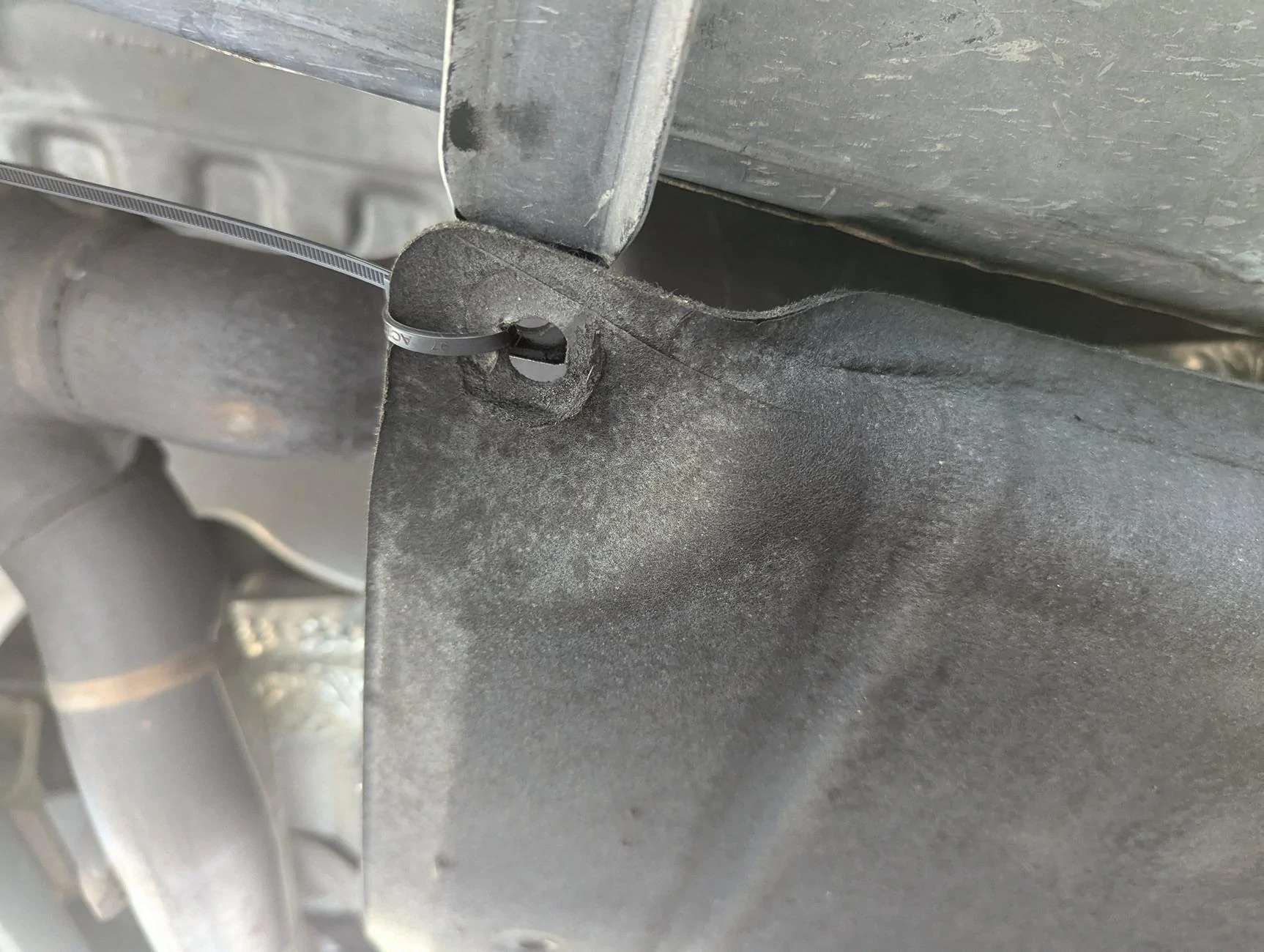

For $1100, I didn't even get a free bolt. Or maybe They felt I owed them more and they traded me a bolt for a zip tie. They didn't even trim the tail. :facepalm:
Seems weird I felt the need to crawl under the truck this morning to actually make sure they replaced the starter.
Dont thinkl I would be taking my truck back to them!!!!

Definitely not.
