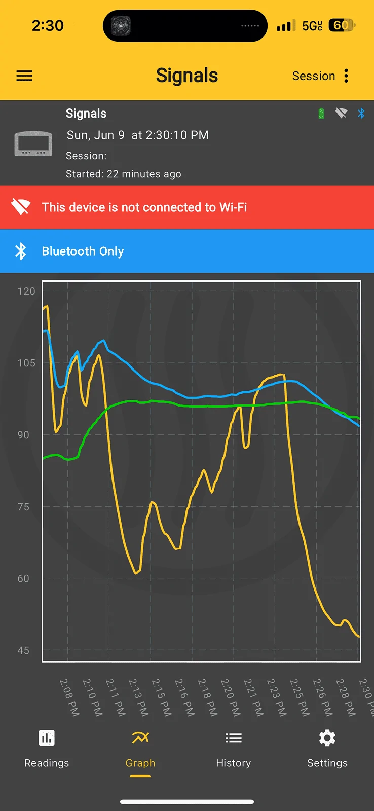

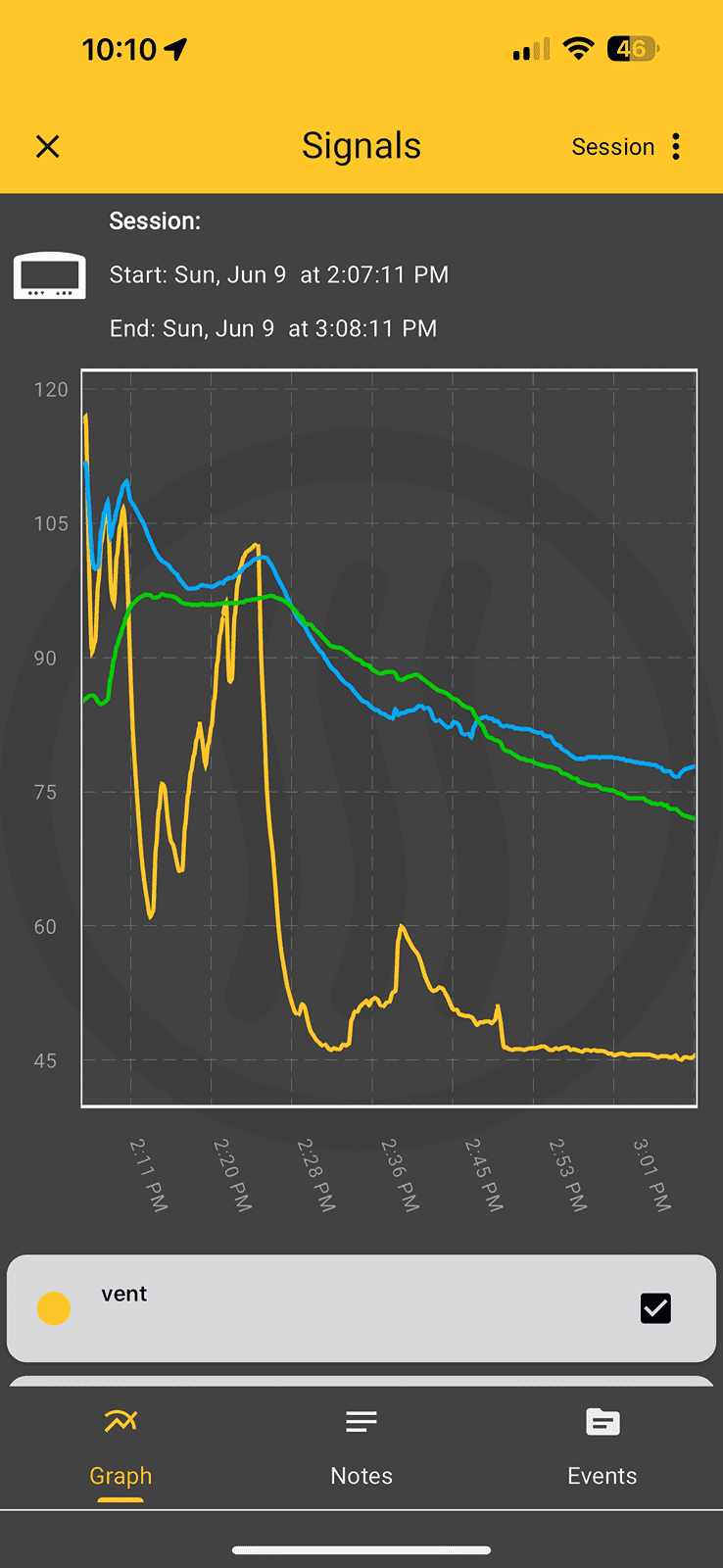

Thanks to everyone for the advice so far! I did the logging and got almost exactly what I had described. Yellow is the vent temp, blue is the cabin temp, green starts outside then gets pulled inside. I did video for 20 minutes so if you really want to bore yourself and listen to me sweat I can post that, but the log image and description should be sufficient. I'll break it into stages and behaviors. Times are rough for the description, but I do have exact stamps in the video that I'm working off. I probably should get that ODB logger a lot of you guys have, been eyeing that for a while, then I could directly overlay the temp and engine status behavior.
Before I dive into the details, in the 6th section I did have a surprise, I forced the engine to idle for 2 minutes but the temps did not drop, so maybe it isn't engine on but vehicle moving? I will need to get more data on that, moving in EV and stopped in IC.
Driveway Idle: 2:07-2:11, 4 minutes
stayed in EV mode the whole time, set temp to 63 and fan speed to 5. Temp in the vent dropped initially but only made it down to 90 degrees, I think it might have been due to a drive I took about an hour earlier. Then the temp bounced between 95 and 105 in the vent, cabin temp was over 100.(this is about how I find my truck after 5-10 minutes of remote start).
Driving: 2:11-2:13, 2 minutes
It got too hot and I needed AC so I started to drive. at the video 4 minute mark I leave the driveway, at 4:28 the vent temp peaks at 107 then rapidly drops, 79 after 1 minute, 65 after 2 minutes.
Stopped at light: 2:13-2:14, 2 minutes
As soon as I stopped the truck went into EV and within 30 seconds the temps started climbing from 62 up to 75 in 50 seconds.
Driving 2:14-2:15, 1 minute
After 20 seconds of driving the temps started to drop and went from 75 to 66 in one minute
Safeway EV Idle: 2:15-2:21, 7 minutes
As expected shortly after the engine went to EV the temp started to climb from 66 to 82, then there was a click/clunk noise and the temp went from 82 to 78 before climbing back up. I'm assuming the click/clunk noise is related to the AC system on due to the timing before the cold air. It then climbed to 96 when another click/clunk was heard and another short drop followed. I captured the noise in the video attached, it happens right after the temp hits 96.0 in the upper left read out. very shortly after the temp drops from 96 to 86. I decided to put it in max AC for grins and giggles, still in EV mode the temp climbs right back up and starts to level to just over 100.
Safeway forced IC idle 2:21-2:24, 2 minutes
To see if engine on would help I forced idle for a while(video:15:28-17:34) and a surprise to me the temp did not drop as expected. it stabilized out around 102 before I had enough and had to start driving.
Driving: 2:24 - end
When I stopped forcing idle the truck went back to EV and a few seconds after moving there was another clunk(Since the engine wasn't on I could hear it), then the engine kicked on for driving and the vent temp dropped to 50 in a couple minutes. that is when I stopped recording video. The larger time log shows another blip up around 2:40 where I got stuck in stop/go traffic and the vent temp went up to 60, then we started moving again and the vent temp stabilized at 46 for the rest of the drive.
Thanks again for the attention to this thread and helping me!
